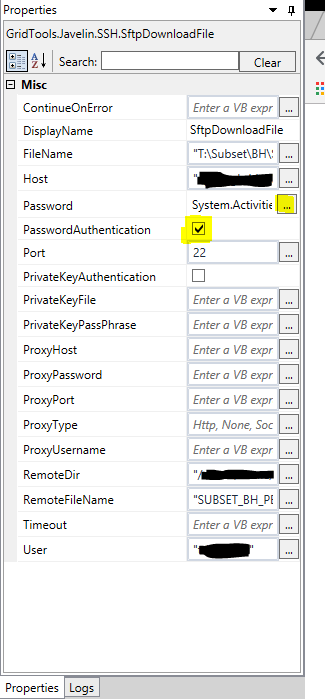

    Hello,
    I use Javelin and the function SFTP - Download File, but when I execute the flow if generates the next error:
    SftpDownloadFile: At least one authentication method should be specified.
    Parameter name: authenticationMethod
    Who I can extract multiple files and fix this error?
    I fill all the Property Names that are necessary:
    And I select the method of the autentication:
    Thanks.

    John,
    What version of Javelin are you running?
    I tested this successfully with 2.0.300.10 (shipped with TDM 4.5).
    Regards,
    Sean

    Hello Sean,
    My version is 2.0.200.2.. I will update to the 2.0.300.10 acording to your information

    Hello Sean,
    Perfect it works with this version, how I can download multiple files, I need download all files with a specific extención, ".dmp" and then upload to a other server all the same files.
    Thanks.
