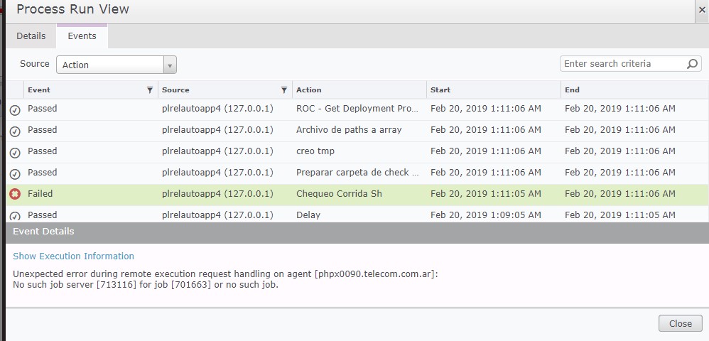

    While executing a deploy all the "run command line" actions that were executed on the phpx0090 server agent returned this error.
    Unexpected error during remote execution request handling on agent [phpx0090.telecom.com.ar]
    No such job server [713116] for job [701663] or no such job.

    When you are checking for the file, does the file exist in the location?
    Can you please give screenshot for the action class configuration for - Chequeo Corrida Sh?

    The problem occurred with all the "run command line" type actions, not particularly with this one, the actions was previously executed in other deployments without the unexpected error appearing.
    The actions that can be seen below also failed and return the same error.
