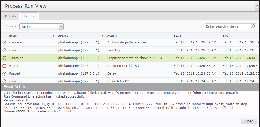

    Hi,  the action "Preparar carpeta de check out - LX" is getting canceled:
    The reason:
    Show Execution Information
    Cancellation reason: Dependee step result evaluator failed, result was [Step Result: true - Executed remotely on agent [phpx0090.telecom.com.ar]:
    Run Command Line action has finished successfully.
    Return value: 0
    Std out: You have mail. [3g H H H H H H H H H x300015 216 214 0 00:09:55 ? 0:00 -sh . ~/.profile;cd /home/x300015/bin;./adas.sh stop x300015 266 216 0 00:09:55 ? 0:00 /bin/ksh ./adas.sh stop x001285 214 1398 0 00:09:55 ? 0:00 /bin/sh -c sudo -i -u x300015 ". ~/.profile;cd /home/x300015/bin;./adas.sh stop" logout
    Std err: stty: : Not a typewriter Not a terminal stty: : Not a typewriter stty: : Not a typewriter stty: : Not a typewriter
    Command line executed: /bin/sh -c sudo -i -u x300015 "ps -fea | grep -v grep | grep adas.sh"
    ], type: PASSED

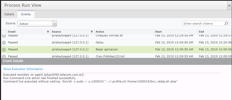

    The strange thing is the action mentioned in the log   that contains, the "adas.sh stop" action is "Bajar aplicacion"

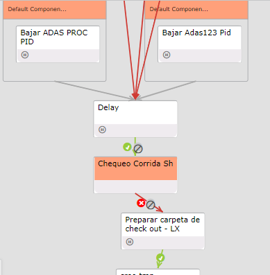

    The flow is the following:
    "Preparar carpeta de check out - LX" should had been executed because "Chequeo Corrida Sh " failed, but for some reason is canceled because "Bajar Aplicacion" was successfull.
