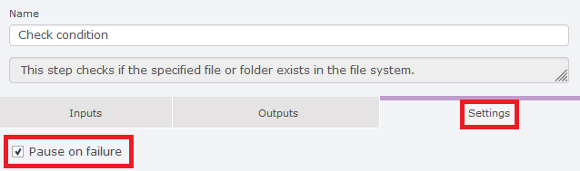

    Pause on failure
    You can configure in action settings when you want to pause on failure.

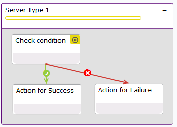

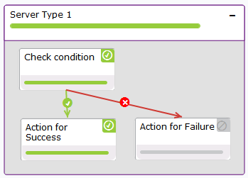

    Set the "Pause on failure" and run following process.

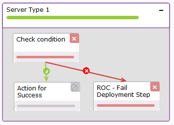

    If the action is succeeded, Passed link will be run and failed link will be cancelled.
    If the action is failed, 2 actions after the failed action will be pending because failed action is just paused.

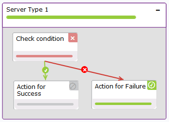

    Uncheck "Pause on failure" on "Check condition" action.
    If the action is failed, failed link will be run and passed link will be cancelled.

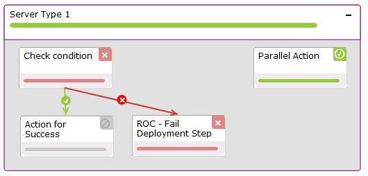

    So, if you use "ROC - Fail Deployment Step" with failed link, this deployment will be failed without pause.

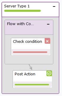

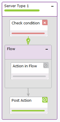

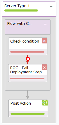

    Flow
    Flow is stateless. Actions after flow will be run even if previous action is failed. (Flow will be cancelled.)
    Even if action in flow is failed, action after flow will be run as well.
    So, "ROC - Fail Deployment Step" action in flow doesn't work as your expectation.
    Parallel actions
    In case which there are some actions without precedent action, although one (Check condition) is failed, another one (Parallel Action) will be run. If you want to cancel all actions as soon as any action is failed, should avoid parallel actions.
