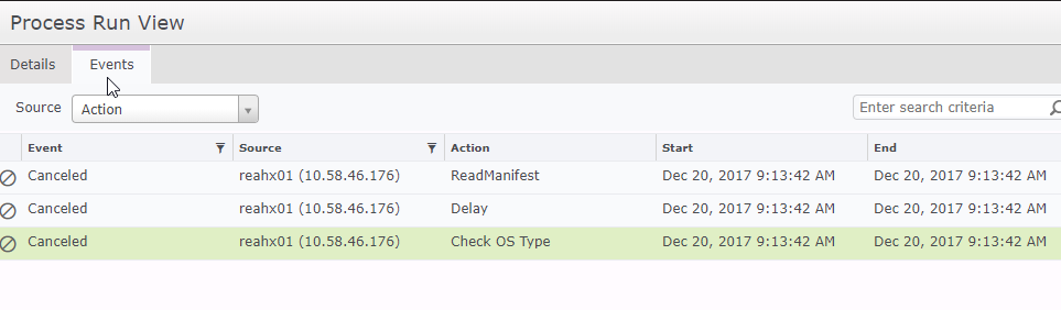

I know that I have to create a deployment plan to test this flow. I did so, one with no deploy, just the pre-deployment and no matter what I do, I always get my process entirely cancelled.
I even tryed a flow with only a check OS action and a delay, but still,

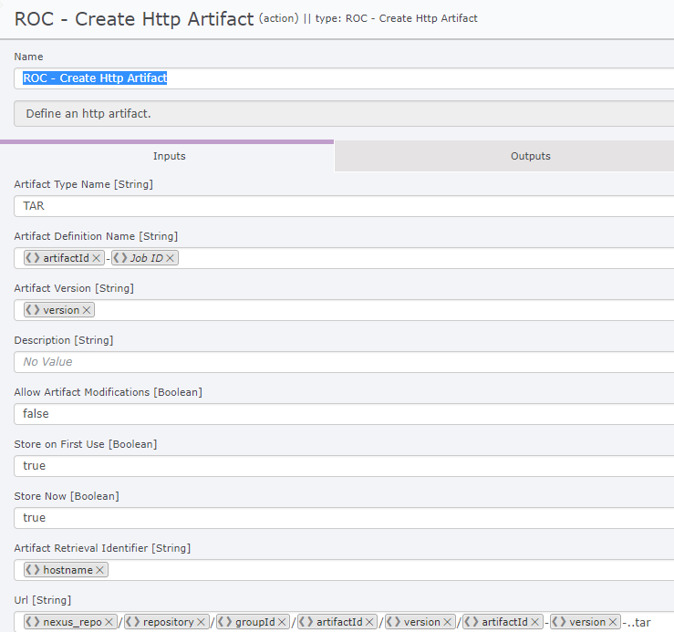

this is my create http artifact
The variables used on the URL I read

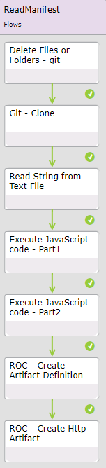

My flow looks like this
what am I doing wrong?
