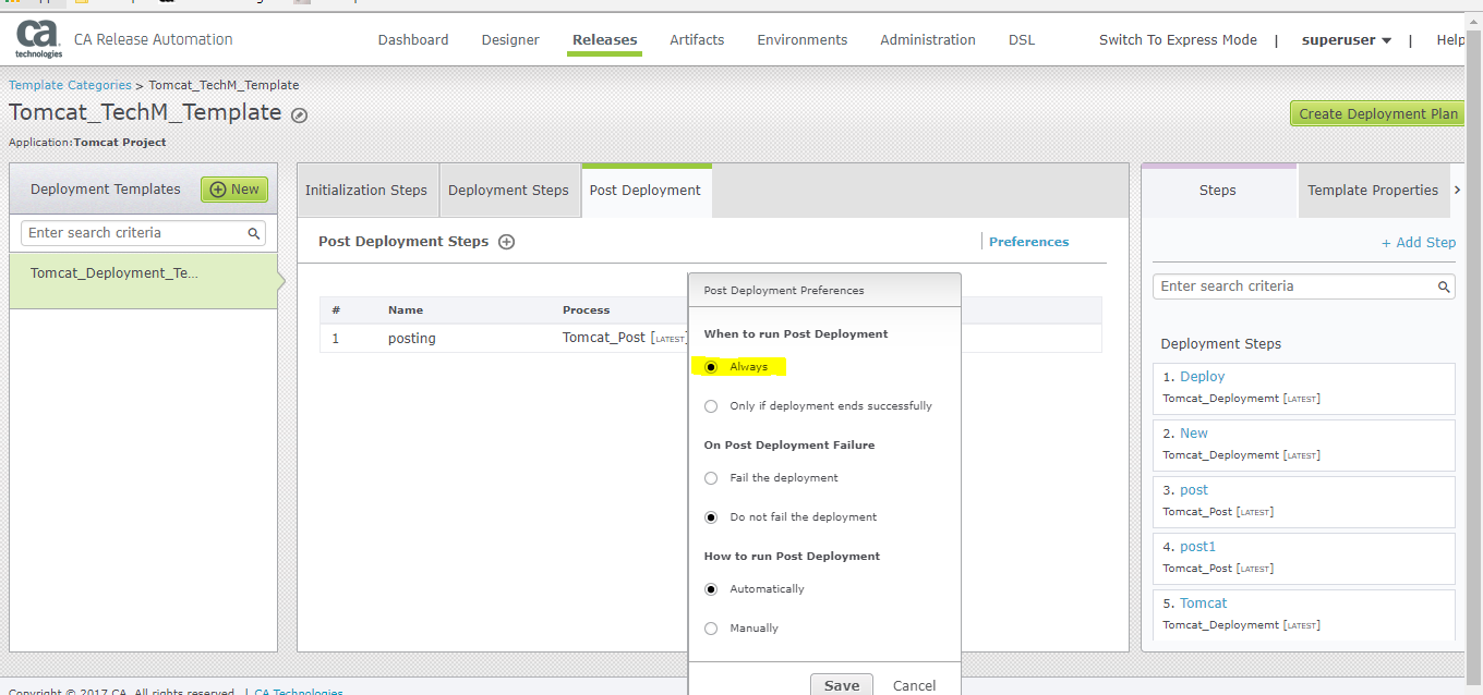

    I would like trigger Post-Deployment when Deployment Step is failed.
    I enabled below option in Post deployment stage to achieve the same

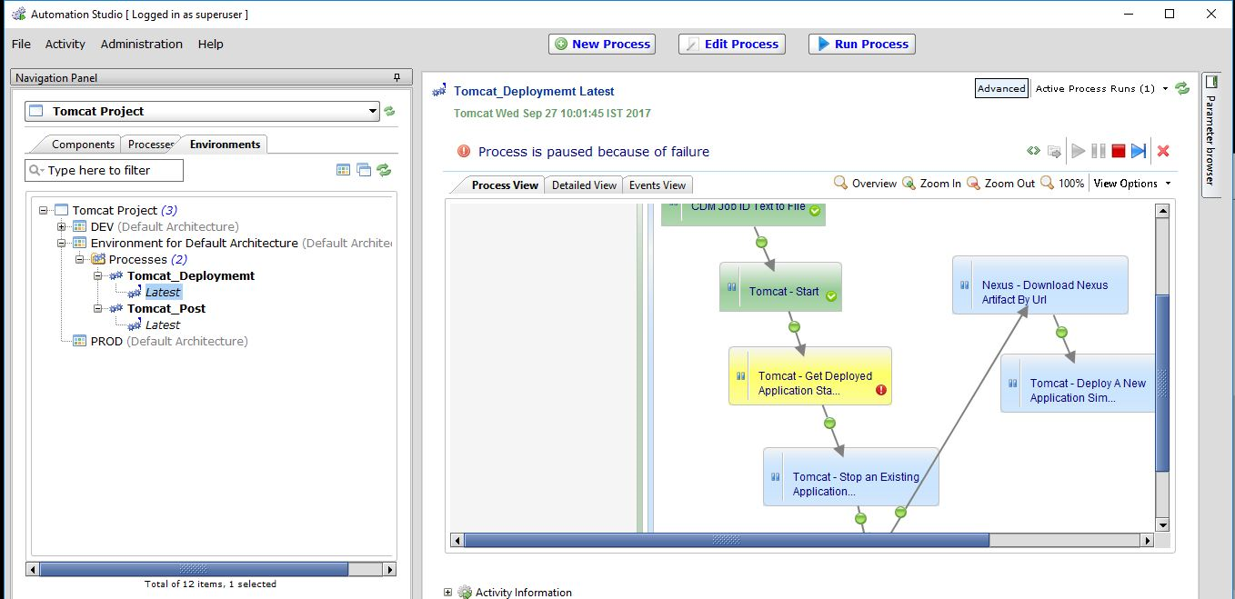

    But My Deployment Step is failed and it not getting in to Post-Deployment stage. Shows below error Process is paused because of failure and it is not automatically moving to post deployment stage ?
    (NOTE :If Stop the process  or Remove the process  then it getting to Post-Deployment stage)
    Now i need the what changes i need to do in order to get in to Post-Deployment stage(when deployment stage fails) triggered automatically apart from above step?

    Hi,
    your post-deployment setting is fine, the thing you're missing is, that you need to stop/fail your deployment step, that is currently stuck in a "failed pause" state if an action fails.
    remove the "pause on failure" flag for the action and make a "on failure"-connection to the action "ROC - Fail Deployment Step" (or similar)
    regards
