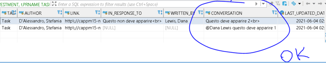

    The queries included in the GEL script I wrote return the correct data - however, I have a problem with the HTML formatting of the email, as currently this is what I am getting:
    Example (X = Dana):
    This is the query result:

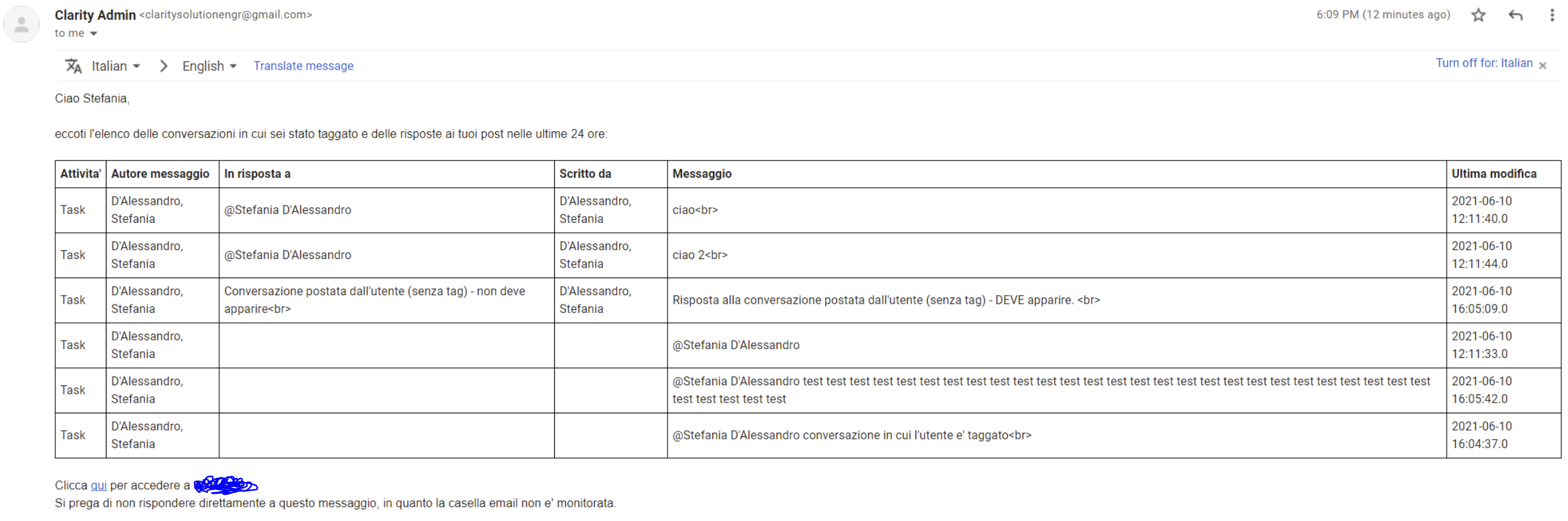

    This is the final result:
    Thanks again!

    Amended script below.

    <gel:out trim="false"> [Query 1] Get Resources </gel:out>
    <sql:query var="cresult" dataSource="${clarityDS}" escapeText="false"><![CDATA[
    SELECT
    r.USER_ID,
    r.FULL_NAME,
    r.EMAIL
    FROM PRTEAM p
    INNER JOIN INV_INVESTMENTS i
    ON i.ID=p.PRPROJECTID
    INNER JOIN SRM_RESOURCES r
    ON p.PRRESOURCEID=r.ID
    WHERE i.ODF_OBJECT_CODE = 'f_attivita'
    ]]></sql:query>
    <gel:out trim="false"> [Query 1] End querying resources data.</gel:out>
    <core:forEach trim="true" items="${cresult.rowsByIndex}" var="crow">
    <core:set value="${crow[0]}" var="resource_id"/>
    <core:set value="${crow[1]}" var="resource_name"/>
    <core:set value="${crow[2]}" var="resource_email"/>
    <gel:out trim="false"> [Resource Info] Internal Resource User ID: ${resource_id} </gel:out>
    <gel:out trim="false"> [Resource Info] Resource Full Name: ${resource_name} </gel:out>
    <gel:out trim="false"> [Resource Info] Resource Email: ${resource_email} </gel:out>
    <gel:out trim="false"> [Query 2] Start Querying Conversation Data.</gel:out>
    <sql:query var="dresult" dataSource="${clarityDS}" escapeText="false"><![CDATA[
    SELECT
    c.ID,
    i.NAME,
    t.PRNAME,
    r.FULL_NAME,
    CONCAT(CONCAT(CONCAT(CONCAT('http\://cappm15-na02/pm/#/investments/cust',REPLACE(INITCAP(i.ODF_OBJECT_CODE),'_','')),'s/'),TO_CHAR(i.ID)),'/tasks'),
    c2.MESSAGE,
    r2.FULL_NAME,
    c.MESSAGE,
    c.LAST_UPDATED_DATE
    FROM NMC_CONVERSATIONS c
    ON r.USER_ID = c.CREATED_BY
    INNER JOIN PRTASK t
    ON c.RESOURCE_ID = t.PRID
    ON t.PRPROJECTID = i.ID
    LEFT OUTER JOIN NMC_CONVERSATIONS c2
    ON c.PARENT_ID = c2.ID
    LEFT OUTER JOIN SRM_RESOURCES r2
    ON r2.USER_ID = c2.CREATED_BY
    WHERE c.RESOURCE_NAME = 'tasks'
    AND i.ODF_OBJECT_CODE IN ('f_attivita', 'f_assenze')
    AND r.IS_ACTIVE = 1
    AND c.LAST_UPDATED_DATE >= SYSDATE - 1
    AND ( r2.USER_ID = ${resource_id}
    OR
    ( SELECT COUNT(*)
    FROM NMC_CONV_REFERENCES m
    WHERE m.DATA_ID = ${resource_id}
    AND m.CONVERSATION_ID = c.ID) != 0
    ]]></sql:query>

  • 6.  RE: Help with HTML Formatting in GEL
    Broadcom Employee
    Posted 6 days ago
    Edited by Stefania DAlessandro 6 days ago
    Updated gel:email piece >
    <gel:email from="stefania.dalessandro@broadcom.com" fromName="Clarity Admin" to="${resource_email}" subject="XXX: conversazioni delle ultime 24 ore"><![CDATA[<html>
    <head>
    <style>
    table, th, td {
    border: 1px solid black;
    border-collapse: collapse;
    th, td {
    padding: 5px;
    th {
    text-align: center;
    </style>
    </head>
    <body>
    Ciao ${resource_name}, <br/>
    <br/>
    eccoti l'elenco delle conversazioni in cui sei stato taggato e delle risposte ai tuoi post nelle ultime 24 ore: <br/>
    <br/>
    <table>
    ${v_mail_content}
    </table></br>
    </br>
    <br> Clicca <a href="XXX">qui</a> per accedere a XXX. </br>
    </br>
    <br> Si prega di non rispondere direttamente a questo messaggio, in quanto la casella email non e' monitorata.</br>
    </body>
    </html>]]></gel:email>
