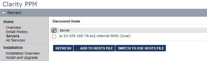

    I am setting up a new clarity server cluster. I have currently 2 servers, one with CSA. I am not able to see 2 servers on the CSA servers list, I can see only the node on which CSA is running. I have tried autodiscovery as well as clarity hosts.xml file, without success.
    Setup Done:
    Version: Clarity 15.8.1
    OS: CentOS
    Sever 1:
    Added NSA, App, App2, BG, Beacon
    Enabled JDBC Ping using  (CSA: Configure JDBC Ping As An Alternative to Multicast (broadcom.com))
    OS Hosts file has the entry for 127.0.0.1 localhost with hostname
    Multicast Setting:
      <nsa bindAddress="10.105.165.75" multicastAddress="230.0.10.6" multicastPort="9090" clientPort="9091" serviceName="Clarity PPM Beacon" serviceUser="" servicePassword="" autoStartService="true" autoDiscovery="true" useJDBCPing="true"/>
    Server 2:
    Added App, App2, Bg, Beacon
    Enabled JDBC Ping
      <nsa bindAddress="10.105.165.78" multicastAddress="230.0.10.6" multicastPort="9090" clientPort="9091" serviceName="Clarity PPM Beacon" serviceUser="" servicePassword="" autoStartService="true" autoDiscovery="true" useJDBCPing="true"/>​​

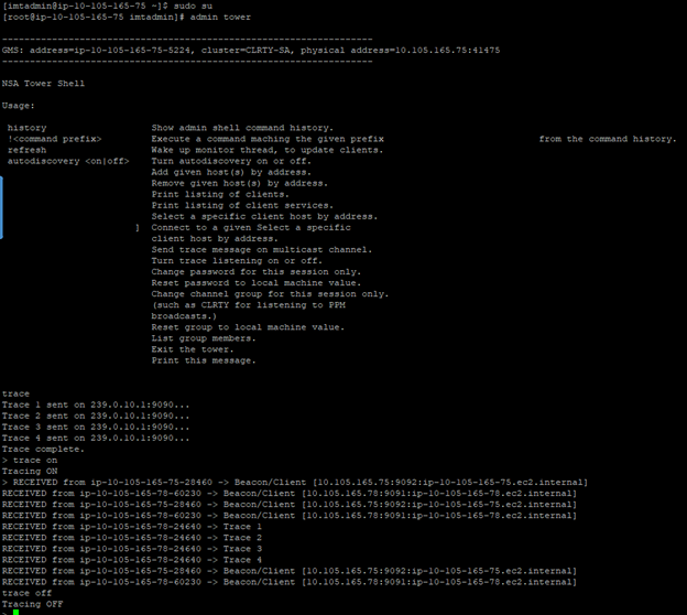

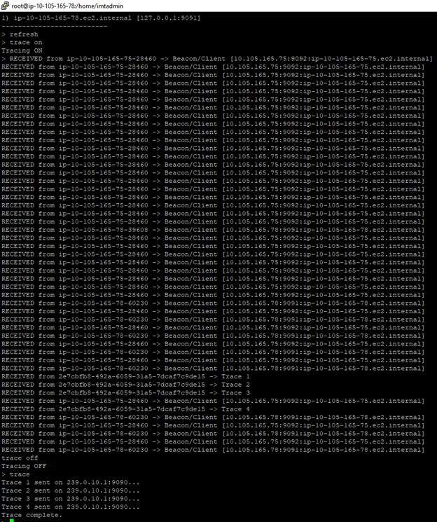

    I can do admin tower and trace works in both directions.
    Server 1 Traces:
    Server 2 Traces:

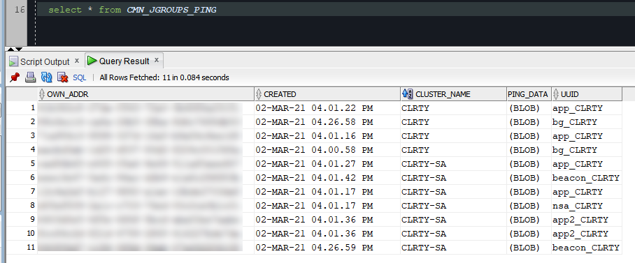

    JDBC Ping database entries:
    I have referred following documents:
    Clarity: Fact Sheet: Clarity Beacon with Multicasting - include FAQs. (broadcom.com)
    CA Clarity PPM on VMWare: avoid multicast issues when using vSwitch (broadcom.com)
    Testing for Active Nodes in the Cluster - Clarity (broadcom.com)
    Am I missing anything?
