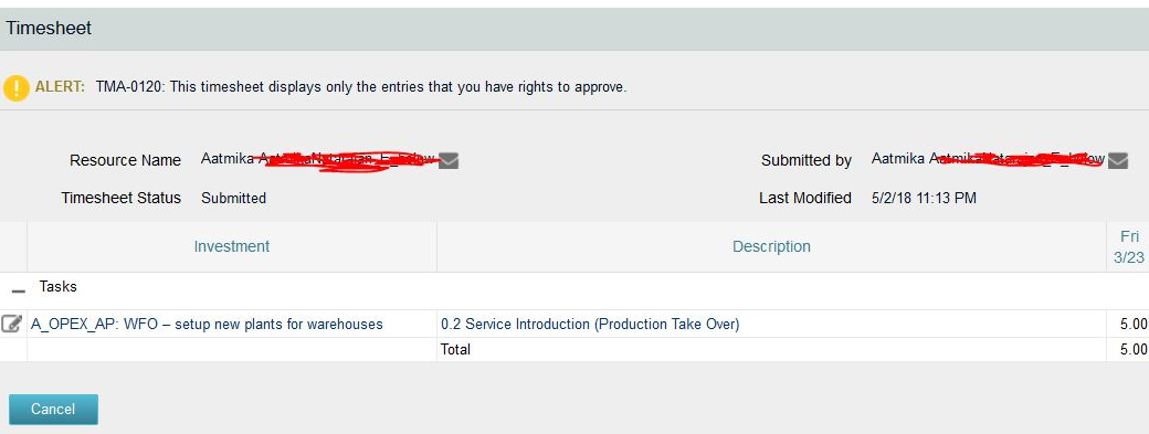

    Generally when user submits hours of some project in his Timesheet,  PM of that project can see those hours of user. We'd like to know which right is responsible for this access, because we would like to add that right to some second manager of project to see the same hours:

    Like the "Alert" in your screenshot says ; its just the "Time Approval" rights (its a right over the resource though, not the project).

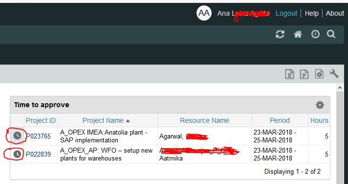

    We have built custom portlet where PMs see Submitted TS with their projects. We use link for Timesheet icon to refer to the respective timesheet (line link in Action Item) where PM can check submitted hours with tasks.
    So then I'm referring to this fact:

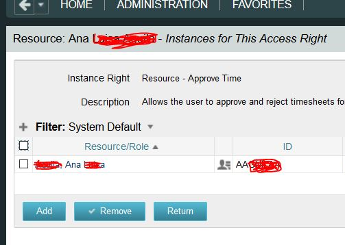

    Project manager Ana (logged in) -
    is PM in project for resource "Aatmika" - where she can see submitted hours when clicked on TS icon:

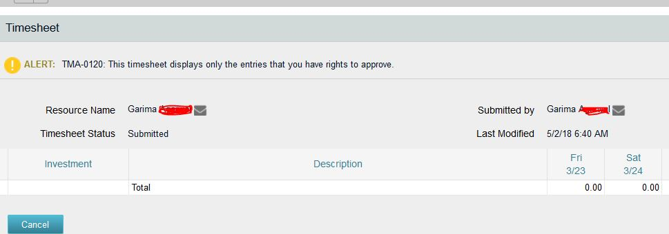

    but for resource "Agarwal", in second project - is Ana this "second PM", where she can't see anything (when click on TS icon):
    In spite of fact, project manager Ana has only herself in Resource - Approve time right:
    So I still think it's some different right, but probably some built-in which we can't "simply use"...
    Maybe the only way is add resources to  Resource - Approve time right. Thanks for your tips.
    Ok, but that last screenshot only shows you the specific instances that Ana has "Approve Time" over (so resources that have a 1-to-1 approve-time relationship) - the "Approve Time" right can be obtained in various other ways (via groups, OBS relationships (this is the most complex), or globally) that would allow Ana to approve time for the timesheet-resource ; how you work that out is via that "Full View" / key-icon functionality I've mentioned above.
