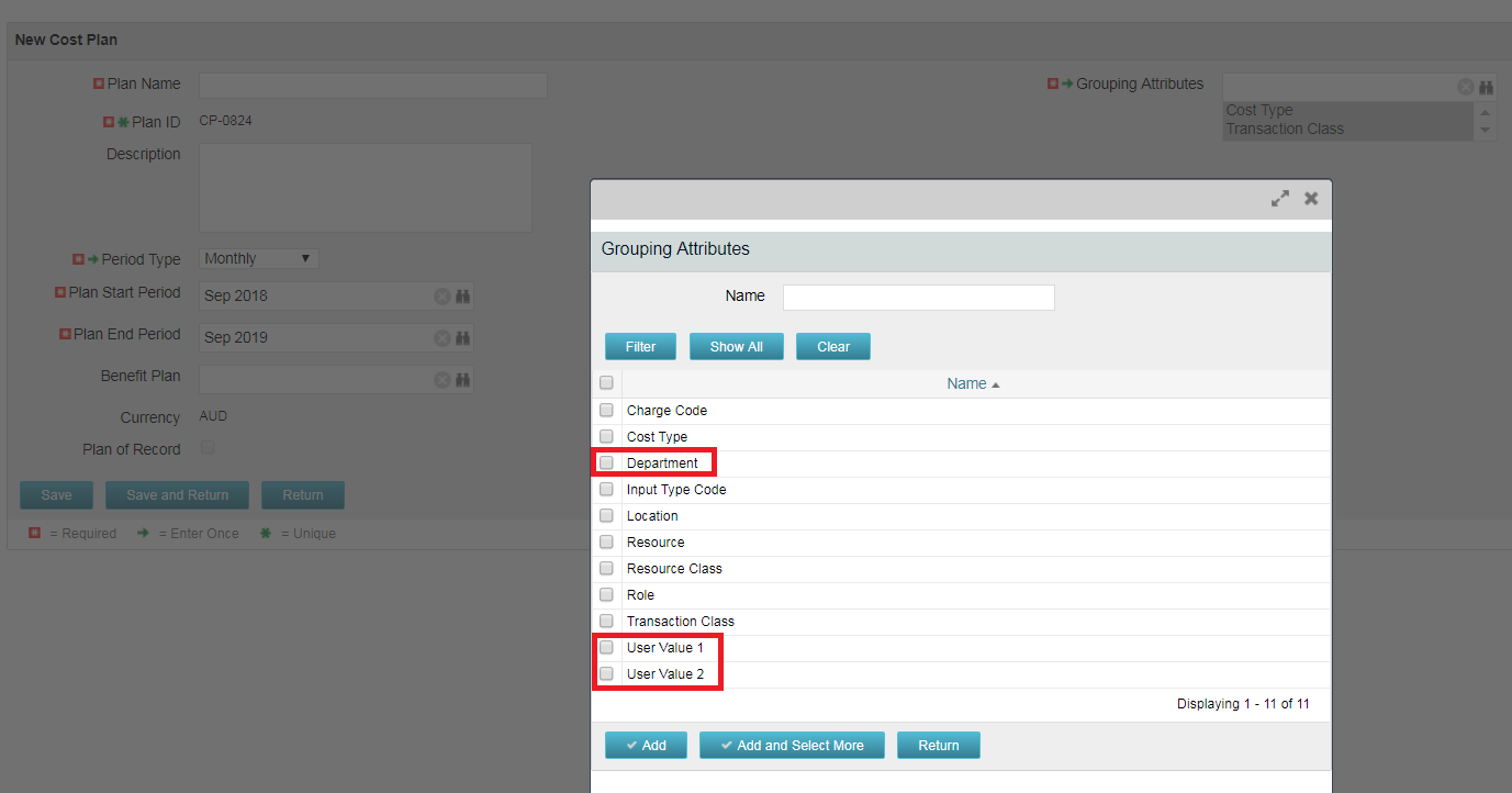

    Is there any way in CA PPM to implement that a project has financing from different departments in a company, or from different companies in a group?
  • 2.  Re: Different funding sources for a project in CA PPM
    Posted Jan 29, 2019 06:13 PM
    Yes, you can group the funding from different departments through grouping attributes in a cost/budget plan. We can either setup departments(which can be funding sources to the project) and use those departments as grouping attributes to segregates those costs in a cost plan.
    Alternatively, you can rely on User Lov 1 Lookup to setup custom funding source values and use User Lov 1 as a grouping attribute in a cost plan.
    Regards
    Praneeth
