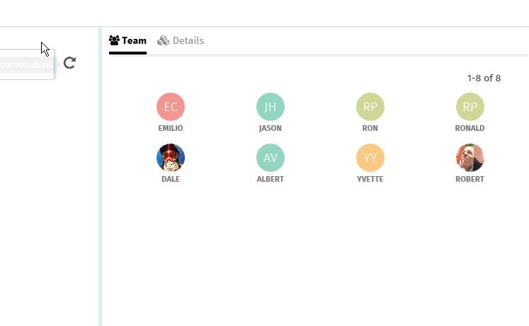

  • 3.  Re: 15.x - Hide inactive team member
    Posted Apr 19, 2018 06:09 PM
    Guess I should have said New UX.
    In this example, Ron left the company - inactive user and inactive resource; Jason left the team - active user, active resource, booked time to project, but is now inactive on this team.
    Understand filtering on Classic side - I only see my six active team members, there.  I don't see means to filter on New UX side, having looked at both 15.2 and 15.4.

  • 4.  Re: 15.x - Hide inactive team member
    Best Answer
    Broadcom Employee
    Posted Apr 20, 2018 01:34 PM
    Hi Dale
    Unfortunately currently it's not possible to filter Team in New UX - Conversations screen. I checked with Product Management and adding a filtering on the grid is planned, not for the next release though as far as I know. Should be coming soon after that if everything goes well as planned!
