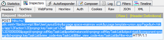

    Method 1: Fiddler
    Fiddler can be used to retrieve the needed URL to restore defaults if the user cannot get to the Restore Defaults page due to the issue they are facing. Fiddler is needed in that situation since PPM does not reflect the link for the Restore Defaults page in the URL.
    Below are the steps on how to do this:
    1) Install the Fiddler2 tool. The link to download this can be found at: http://www.telerik.com/download/fiddler/fiddler2.
    2) Log in to PPM as a user who does not have the issue.
    3) Navigate to the page where the user is facing the issue.
    4) Launch Fiddler.
    5) Once Fiddler is open, go back to PPM and click on the Options icon in the upper right hand corner, then select Configure.
    6) Go to Fiddler and click on the last link, which should be the trace for navigating to the configure page in Clarity.
    7) In the request headers section, copy everything after "action=" and prior to "HTTP/1.1".

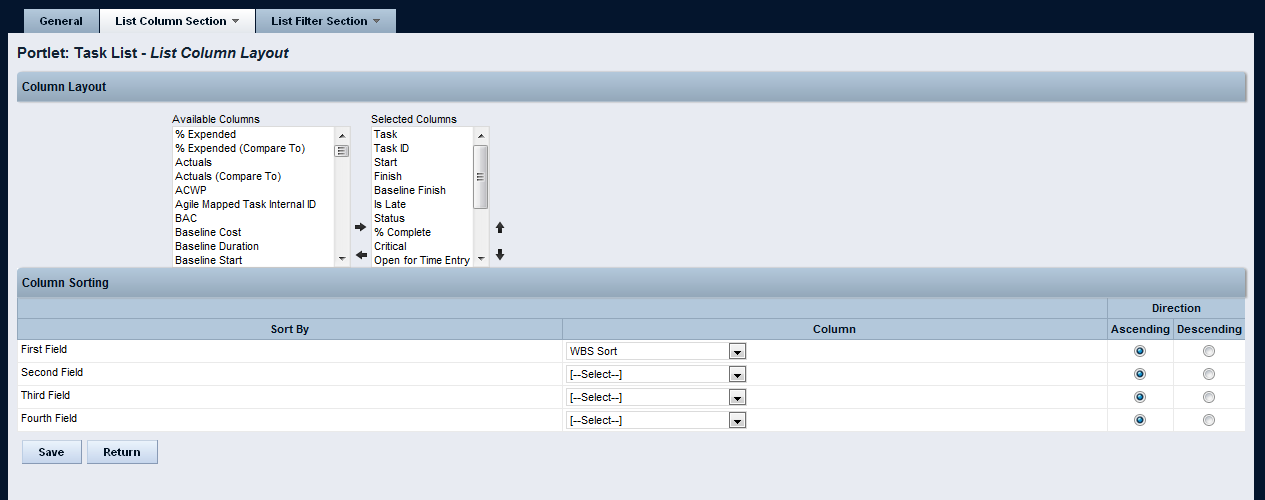

    10) This will take you to the List Column Layout view.
    Note:  It’s recommended to take a screen shot of the view you see on the List Column – Section for two reasons:
    a) This will help in troubleshooting to determine if a particular field the user added is causing the issue.
    b) Users may have customizations in their view they don’t want to lose. Since restoring defaults removes user’s customizations, taking a capture of the view will enable the user to reconfigure their view after restoring defaults.
    11) Click on the General tab, then click Restore Defaults.
    You may get system errors when trying to take users directly to the General tab from Fiddler, so that is why we recommend taking the Fiddler URL directly after clicking Configure (This places you on the List Column - Section page and not on the General tab).
