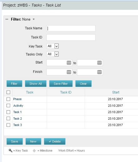

    I am not quite sure if that is quite correct.
    You say
    none of my prtask values have value for PREXTERNALID
    I think the way it goes is that for XOGing if one task has External ID then all tasks XOGed must have External ID and if none has External ID then External ID is not needed in XOGing (on the outset that none in the input file has). This seems to work at least in 15.3
    So if I have a proejct like this
    and write a new task without external ID with
    <NikuDataBus xmlns:xsi="http://www.w3.org/2001/XMLSchema-instance" xsi:noNamespaceSchemaLocation="../xsd/nikuxog_read.xsd">
    <Header action="write" externalSource="NIKU" objectType="project" version="15.3.0.200"/>
      <Projects>
        <Project name="zWBS" projectID="PR2001" >
          <Tasks>
            <Task  name="Task 3"  orderID="5" outlineLevel="3"  summary="false">
              <estimateRules/>
            </Task>
          </Tasks>
          <Allocations/>
          <scenarioDependencies/>
          <InvestmentAssociations>
            <Allocations/>
            <Hierarchies/>
          </InvestmentAssociations>
          <General />
          <OBSAssocs complete="false"/>
        </Project>
      </Projects>
    </NikuDataBus>
    I get
    Which I think is somewhat like you wanted.

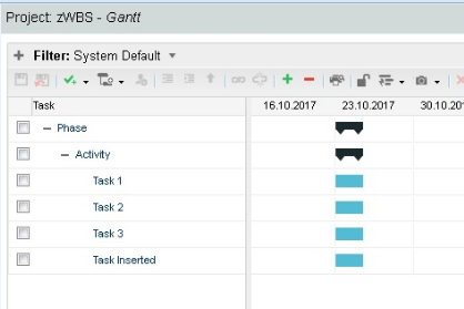

    So if I have input file
      <Projects>
          <Tasks>
            <Task  name="Task Inserted"  orderID="3" outlineLevel="3"  summary="false">
              <estimateRules/>
            </Task>
          </Tasks>
          <Allocations/>
            <Allocations/>
            <Hierarchies/>
          <General />
        </Project>
      </Projects>
    </NikuDataBus>
    Note the task name and orderID
    That will give me
    So XOG did not pay any attention to the orderID..
    Note that this was in 15.3 and for the lowest level WBS item.
    I think you could test how far you get.
