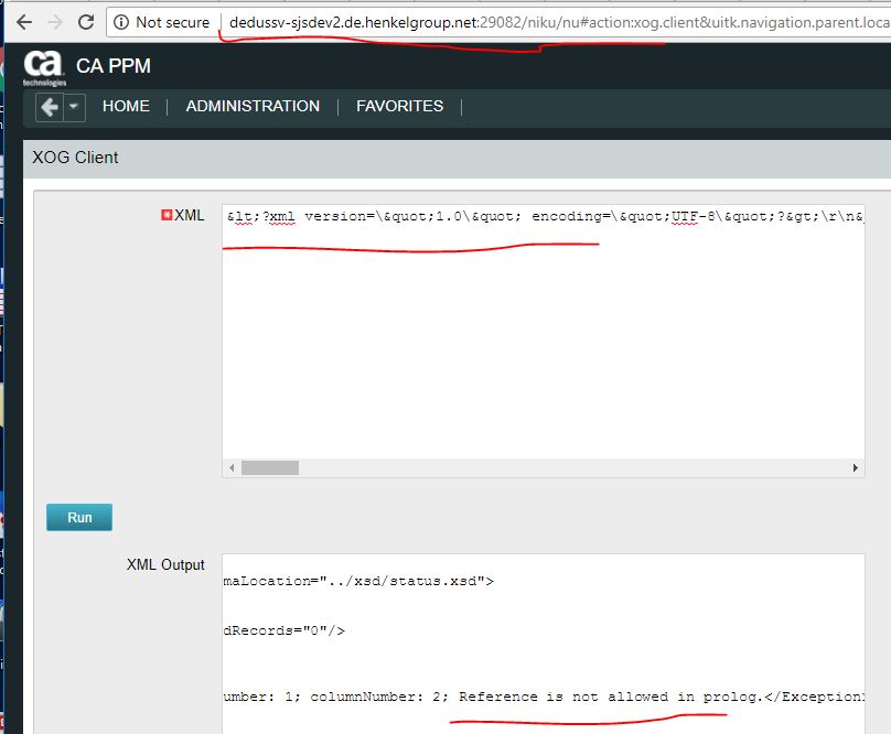

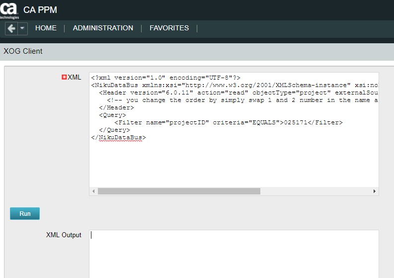

    Hi All,
    we are currently facing very strange issue for us we have never met before. We are using XOG (through Clarity GUI and also by command line) for many years. Firstly this week our Clarity GUI interface started to "ignore" XML characters, or better say encoding and produced error: Reference is not allowed in prolog.
    I tried to change encoding to: UTF-8, UTF-8 without BOM, ANSI – without success.
    Exactly this XOG (and all others I tried) works last week.
    After this situation I tried to use command line where another strange issue appeared. When used properties (attached) file (1. attempt) - I'm not able to connect. However through plain command line login I can (2. attempt) ...

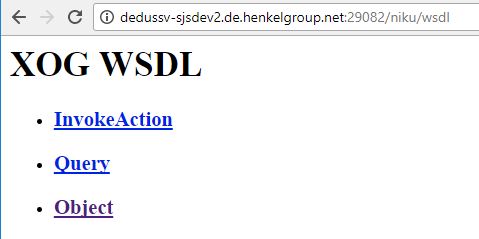

    However when I click on that URL, it is accessible and valid, as it should be...:
    Do you know what this can cause?

    I have seen that "prolog" error when the XML text had been editted in a "funny" editor (such as Word) rather than a clean /text-only editor (such as Notepad++, PFE etc).
    i.e. something to do with the encoding on the XML file itself rather than the XML in the file.
    When I got it, just pasting the XML into a text-only editor and saving it "fixed" it.
    (Search for "prolog" on this community and you'll see it come up a few times)

    Hi Dave,
    Yes i think the same. Problem is I'm using Notepad++ for a years without any issue like that.... Haven't changed any encoding also. When I searched for "prolog" I found advises like this - not use "funny" editors...
    Matej
