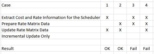

    The Rate Matrix Extraction job completes with the following settings checked:
    • Extract Cost and Rate Information for the Scheduler & Update Rate Matrix Data
    • Prepare Rate Matrix Data & Update Rate Matrix Data
    The Rate Matrix Extraction job fails with the following settings checked:
    • Extract Cost and Rate Information for the Scheduler & Prepare Rate Matrix Data
    • Extract Cost and Rate Information for the Scheduler,  Prepare Rate Matrix Data & Update Rate Matrix Data

    Looking at info on RME in  earlier versions and thinking in writing.
    You say
    Looking at TecDoc 439334
    http://www.ca.com/us/support/ca-support-online/product-content/knowledgebase-articles/tec439334.aspx
    In the first case old data is used.
    In the second case the new data is used but not extracted to the scheduler.
    In the third case the data is prepared, but updated and my assumption is that the information extracted to the scheduler is the new data as the Extraction to scheduler fails.
    In the last case the new data is used to prepared and updated and extracted to the scheduled but
    [CA Clarity][SQLServer JDBC Driver][SQLServer]Arithmetic overflow error converting expression to data type datetime.
    Either that is a bug or there is a problem with a date field in the matrix
    So go through the dates in the matrix.
