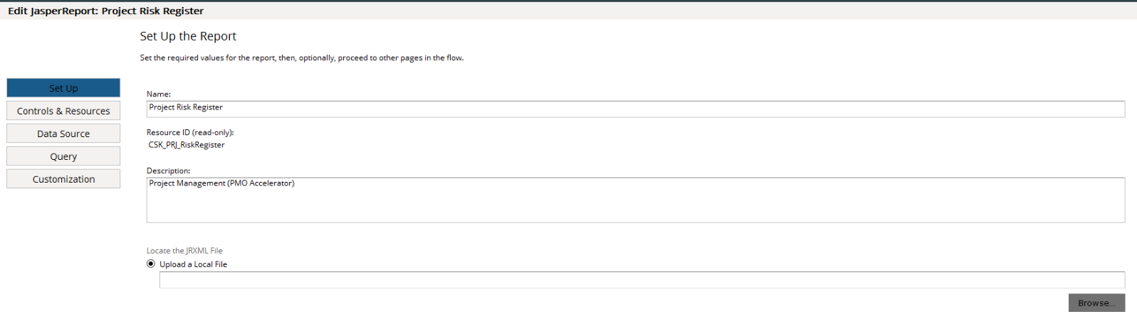

    However, looking at the way you actually deploy the reports, here is what would be a good process, provided you are using and deploying Jaspersoft Studio Reports:
    1. Create and test the report in Jaspersoft Studio
    2. Save the output as jrxml file on your local machine
    3. Now connect to Jaspersoft Console as superuser account
    4. Navigate to the Reports, find the report you want to replace, right-click - Edit
    5. In section Set Up, Upload a Local File - Browse and upload the new jrxml file
    6. Click Submit
    This will replace the report with the new version, and should keep the report name and schedules as they were before. This will also help you with not having too many instances of the same report on the server, which can confuse the users.
