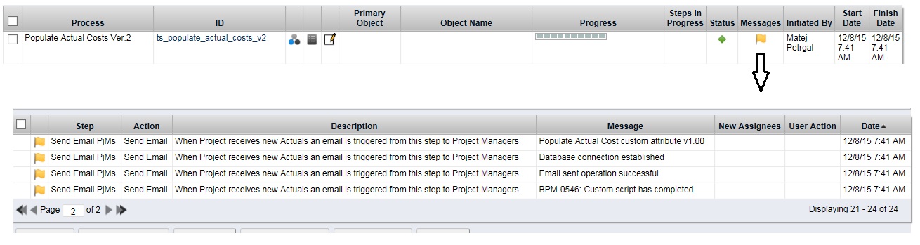

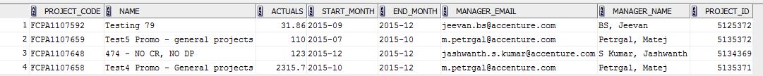

    I've a question if somebody experienced in GEL has ever met with issue with not sending emails in GEL script. Mentioned script runs smoothly without any errors and included SQL gives me 4 results which are expected as
    sent 4 emails to PMs in Clarity. In spite of that no emails are sent. Sending emails in CLarity is working fine for us (tried another processes) so it's not Email server issue. I've tried to also Query withou Sum, Min, Max function, Withou CDATA also, nothing helped.
    Could you please advice what it could be? Thanks a lot
