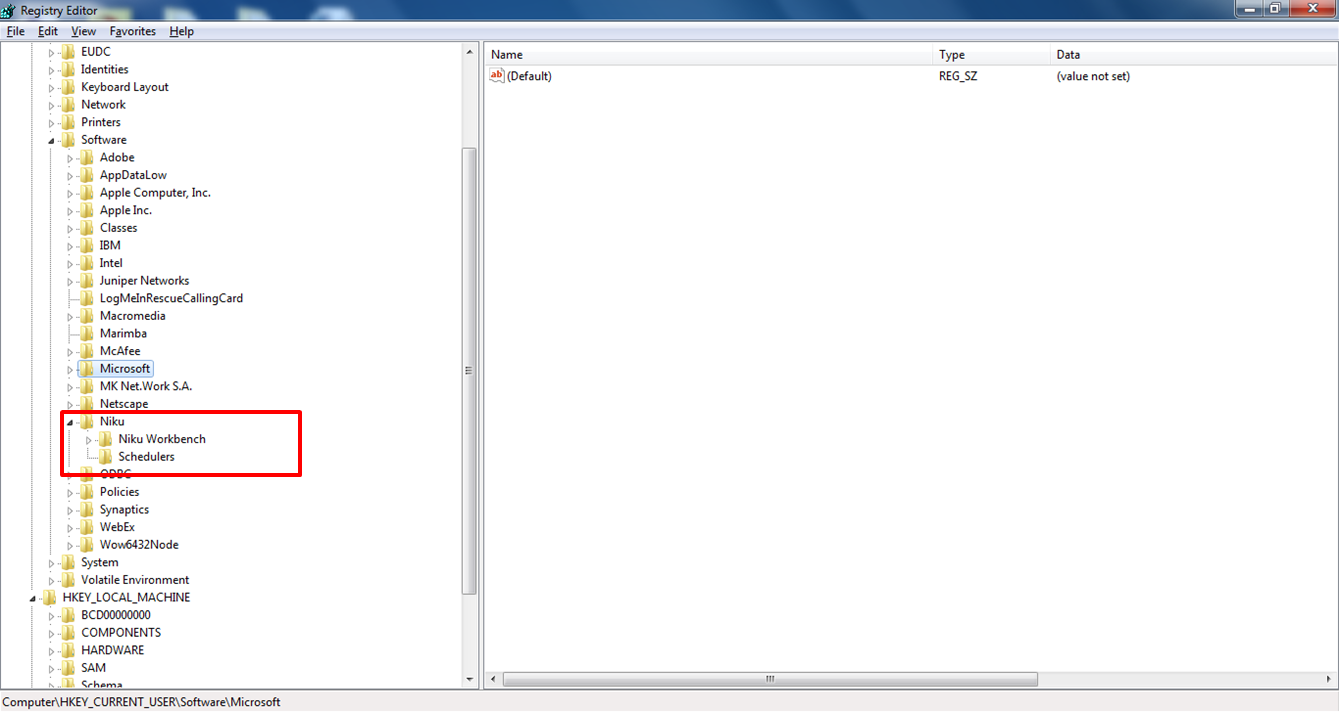

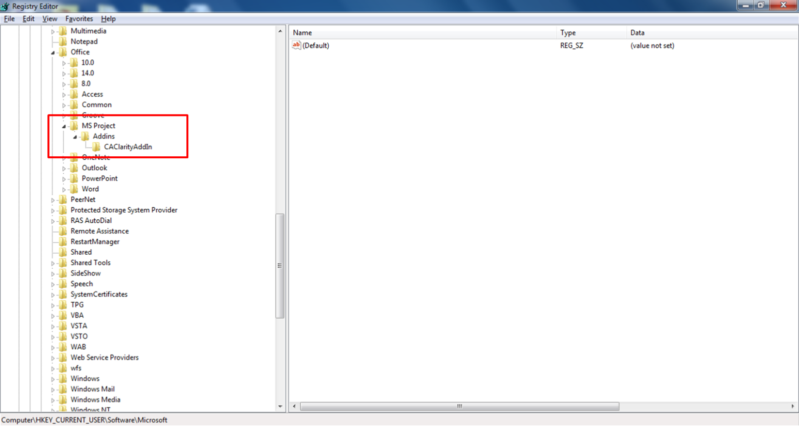

    Thank you for your input, when i go into the reg editor i see the following,
    A Niku folder with workbench as a sub folder
    and withing the office directory, there is the add in information.
    If i can just get the minimum security requirements for the software to install in a win 7 operating system I  think the software engineering team in my company can figure it you, it appears to be a permissions issue with the windows 7 image. I am  trying to ge ta meeting with the CA rep that has my case, however she suggested I create this thread as she only supports single installation. Thank you again for your input in this matter.
