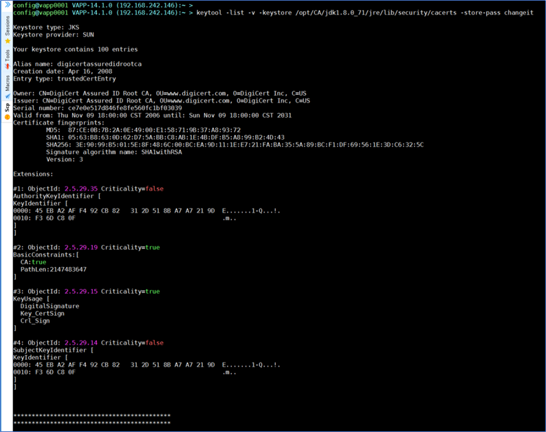

    Hi Larry
       Thanks for your response. PFA screenshot and share your view which would be helpful. Awaiting Reply!

    Hi Kirupakaran
    https://docops.ca.com/ca-identity-suite/14-2/en/virtual-appliance/administering-virtual-appliance
    The embedded httpd service is using the standard JDK keystore, cacerts, and the permissions have been open for this keystore file to replace any CA certs or server certs.
    Administering Virtual Appliance - CA Identity Suite - 14.2 - CA Technologies Documentation
    keytool -list -v -keystore /opt/CA/jdk1.8.0_71/jre/lib/security/cacerts -store-pass changeit
    keytool -printcert -v -file /opt/CA/VirtualAppliance/custom/apache-ssl-certificates/localhost.crt
    ls -lart /opt/CA/VirtualAppliance/custom/apache-ssl-certificates
    ls -lart /opt/CA/jdk1.8.0_71/jre/lib/security/cacerts
    See permission for the "config" userID.
