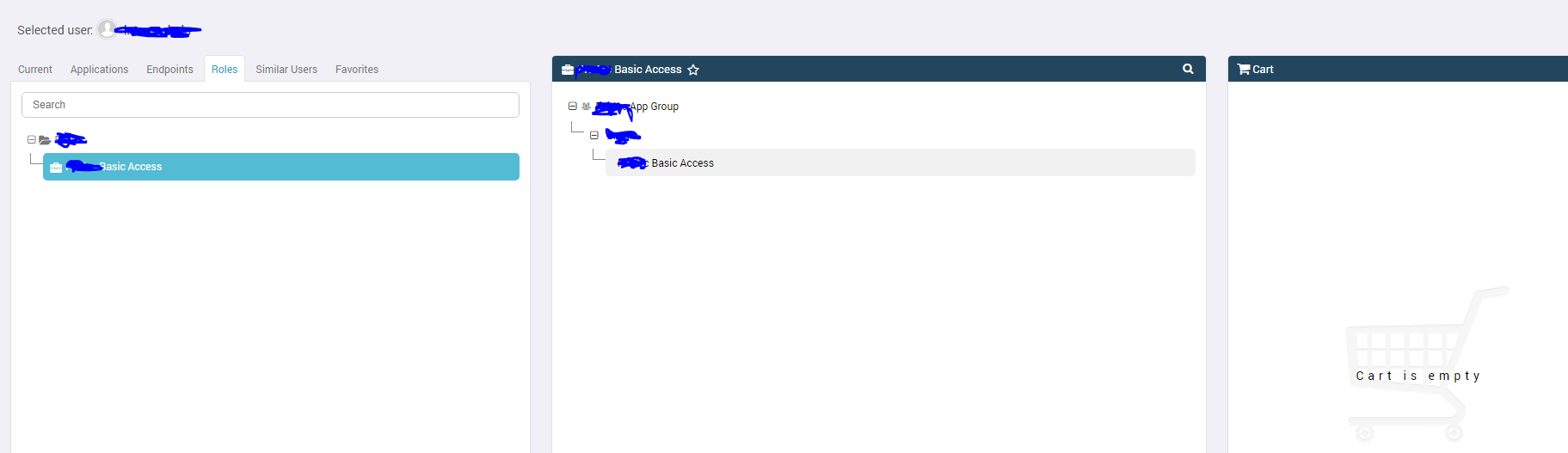

    Posted Jun 27, 2019 09:35 AM
    Yes, I am trying to add using an administrator.
    The user can add/remove members from the role in CA Identity Manager but the add/remove button is not available in the Portal.
    Also, what role do forms play? I have added a form to the add action and linked it to modifyProvisioningRole task. Still no luck. See below screenshot - No add button

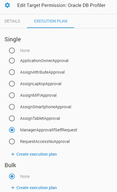

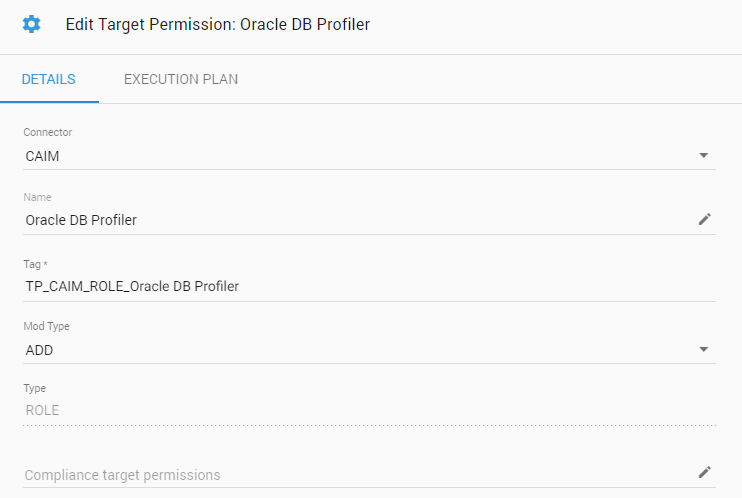

    The flow is as follows:
    1. Define a Provisioning Role in CA Identity Manager (linked to an account template and an endpoint type instance, etc.)
    2. Restart the CA Identity Manager main connector from the Identity Portal Admin UI
    3. Create a Target Permission in IP that is linked to the newly imported Provisioning Role (Mod Type is ADD - see screenshot)
    4. Define your Execution Plan for this Target Permission (select a previously defined Execution Plan):
    5. Your Execution Plan Calls a Form (you previously created) - make sure you define which Forms to call for adding and Removing the role:
    6. The Forms that you call in the Execution Plan (to handle the Add and Remove of the Target Permission) will in turn call specific tasks to execute the Add and Remove actions in the back-end Identity Manager system. The screenshot below shows the details of the Form 'Assign Role Manager Approval' and the task that it calls:
