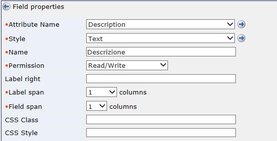

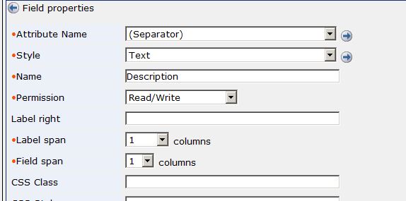

    They duplicate the "Create Active Directory Account - User" screen of the Create Active Directory Account" Task
    The description field has not an Attribute Name (see the screenshot). So If they don't change it, that's ok
    But if they try to change anything in this field, choosing the right Attribute Name (Description) and translating the Label Name, the Description Value is not populated on the Active Directory account.
    Is it a Bug ?

    Can you clarify the issue?   If you choose in the Attribute Name drop down "Description" it is not updating the Active Directory?
  • 3.  Re: "Description" field in the "Create Active Directory Account" Task
    Posted Feb 23, 2017 01:26 PM
    Exactly. With original form in the Admin Task TAB
    it works. This is log

    With the modified Form
    It does not work: This is log (Description Field is not present)
