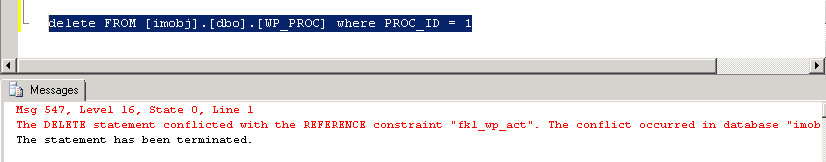

    I reproduced this error on my machine, by running the following query (e.g. trying to remove DeleteOrganizationApproveProcess):

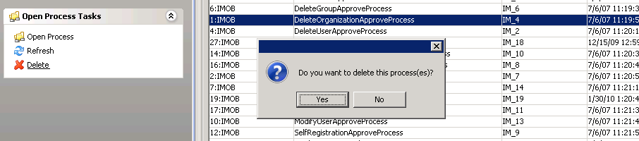

    Once you've cleared all your runtime data, you can remove all static object definitions, e.g. processes, actions, transitions, alerts, forms, scripts, mail etc. You do this from Designer:
    Once it is done, you should have an empty WP_PROC table (among others). The WP_PROC table appearing empty is a clear indication that no more processes are in the system, because it contains the process definition object.
