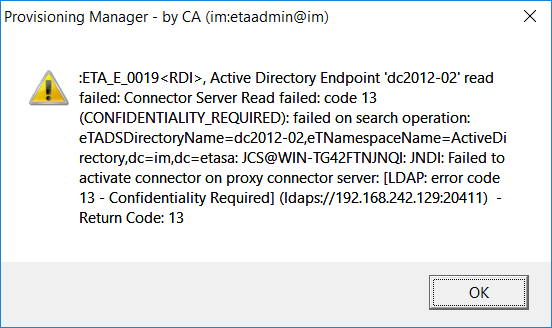

When the error message "Confidentiality_Required" within the LDAP client (Example of Identity Suite's IMPS manager gui ) displays, then view the MS Windows event viewer for System/Schannel messages.

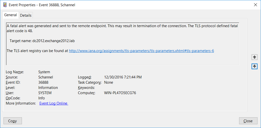

The follow message will be captured on the MS event viewer on the LDAP client server (Example: Identity Suites' CCS server) if the public root CA certificate is NOT deployed to the MS Windows keystore (certlm.msc) on the LDAP client server (Example Identity Suite's CCS server). No message will appear on the ADS DC event viewer.
If the above hyperlink is selected, the website for IANA will display the TLS Alert Code value for error code: 48
Which is "unknown CA", e.g. the public root CA certificate (and/or intermediate CA certs)

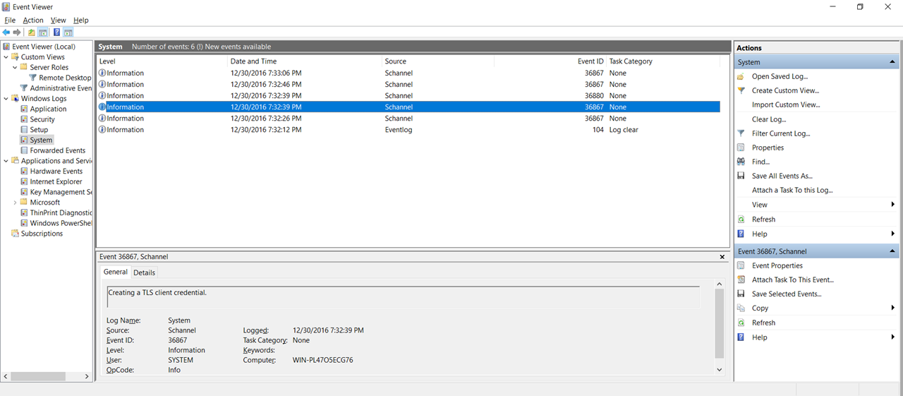

For successful connection stream, to compare, see the following screens:

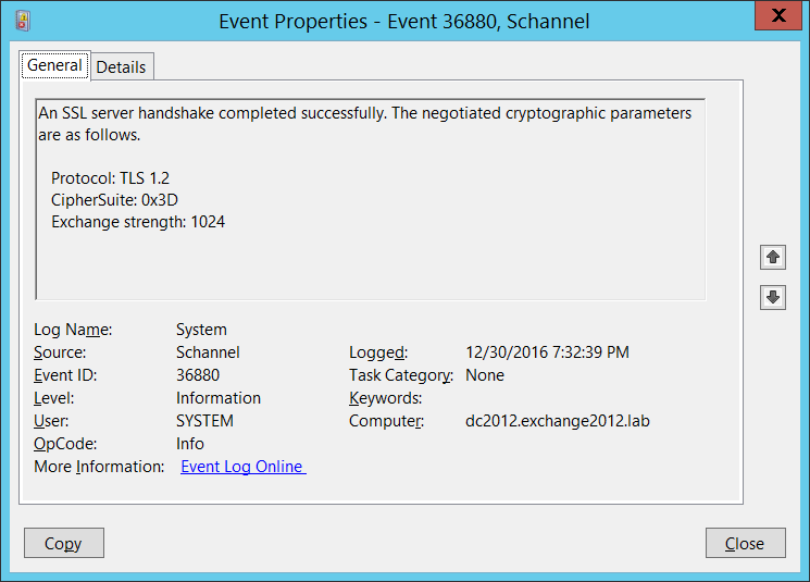

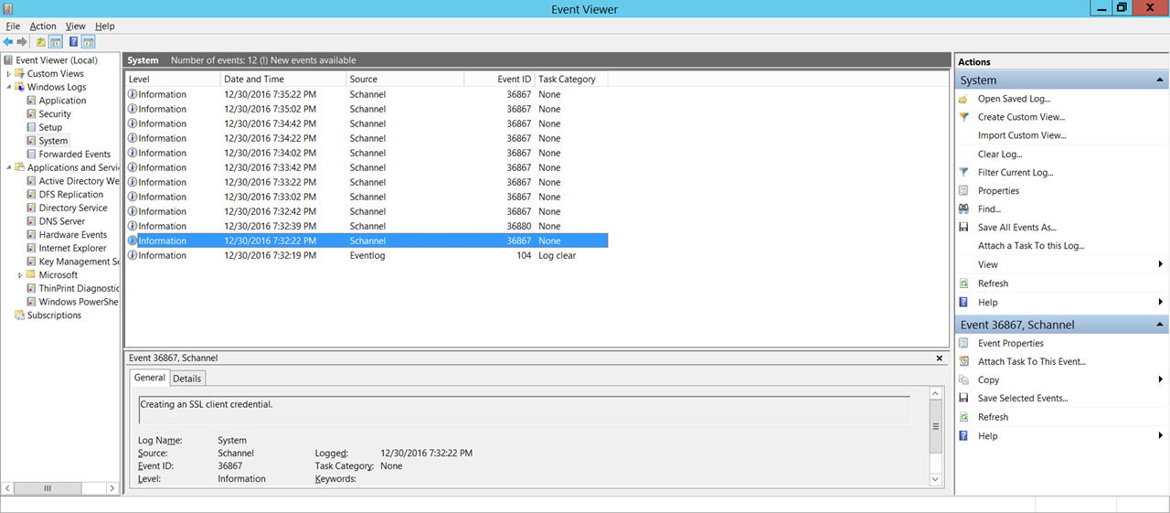

Schannel messages will be captured on BOTH the CCS server AND the ADS DC server.
CCS server below:
On the ADS (2012) Domain Controller server, we see the following:

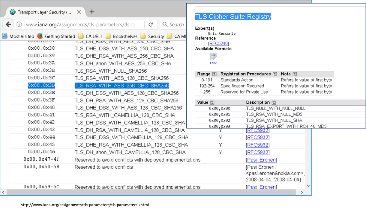

To view WHICH Cipher Suite was used, we can lookup 0x3D from the IANA web site, under the TLS Cipher Suite Registry section.
http://www.iana.org/assignments/tls-parameters/tls-parameters.xhtml
