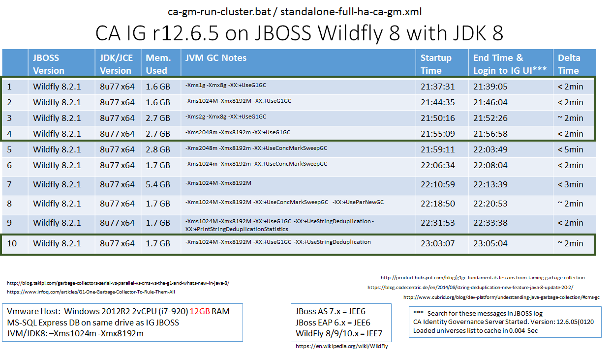

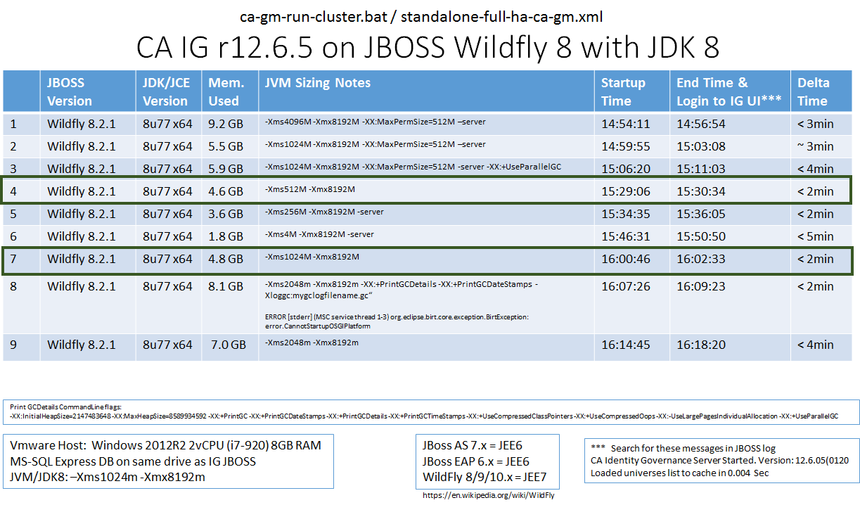

    To determine the max memory & best GC to use for IG, I setup a lab and recorded some basic values for starting up IG and executing some basic loads.
    Here are the results:
    Test One (1):  Which version of Wildfly and JDK will work with IG migration scripts?
    Answer:    Wildfly 8.x.x and both JDK 7 & 8 using the non-clustered startup batch file.
    Test Two (2):  Which version of Wildfly and JDK will work with IG migration scripts?
    Answer:Wildfly 8.x.x and both JDK 7 & 8 using the clustered startup batch file.
    Test Three (3):   Of Wildfly 8.x.x and JDK 8, which is the best min/max memory settings?
    Answer:  See chart.
    Test Four (4):  Which GC will work best for IG on Wildfly 8.x.x and JDK 8?
    Answer:  Appears the latest GC is the best:   G1GC   or  G1GC with the extra flag for strings.
    The default GC of ParallelGC allowed for memory bloat.
    The use of the G1GC with min/max memory settings has a strong value to performance.

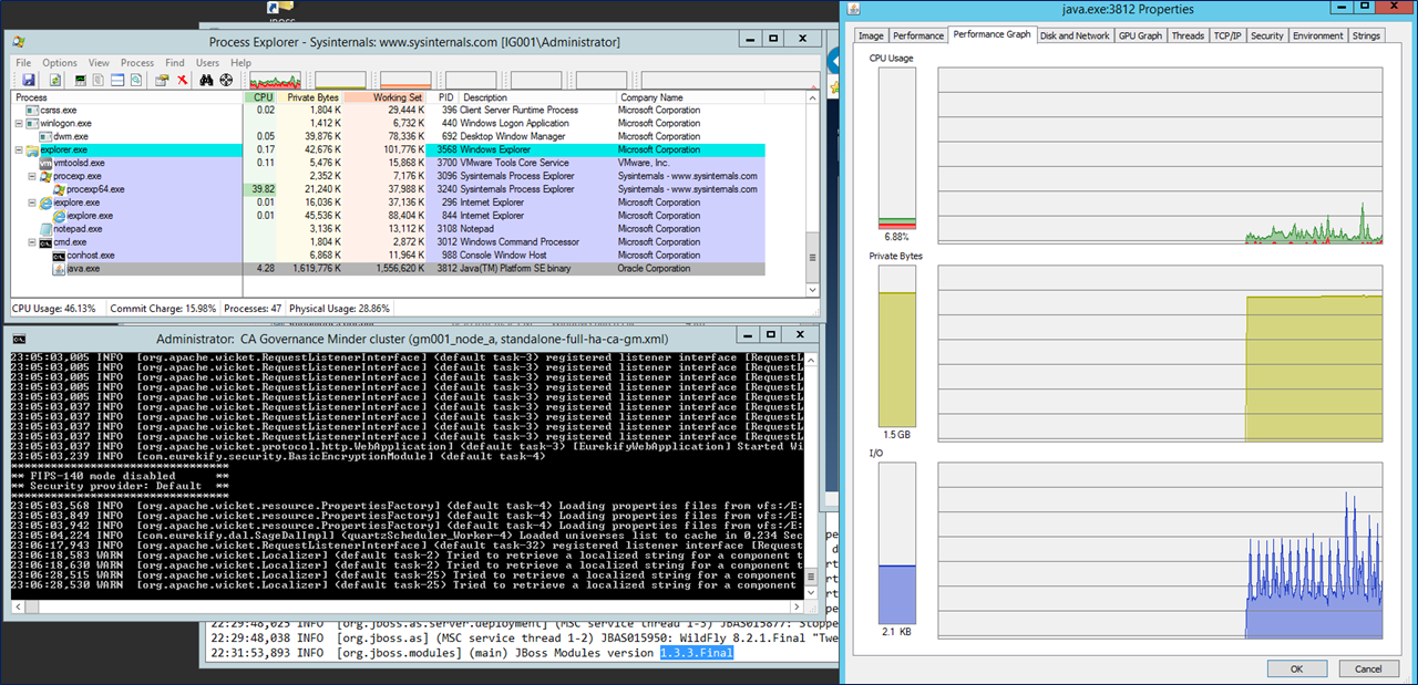

    A view of using the new JVM flags when starting IG.  Monitoring via MS Sysinternals Process Explorer for "java.exe"
    After startup was finished, the CPU utilization dropped to less than 5%.    The CPU heart-beat of the Java.exe was very steady.  No more obvious peaks/valleys.    Memory utilization would resize to immediate needs.
