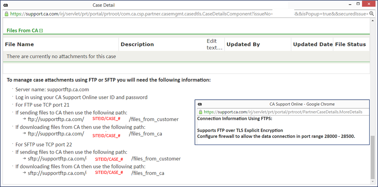

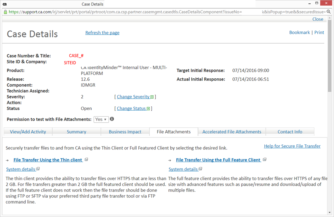

1. Open a new or existing CA Support Ticket. If using the CA Support Ticket for Services, use a Title similar to "File transfer for Services" , note the Case # and Site #, as they will be used for FileZilla
2. Select the TAB "File Attachments" and scroll down to the bottom of the screen. Note the comments on the use of FTP(S) and/or SFTP. Note the dynamic ports needed for FTP with TLS encryption (FileZilla)

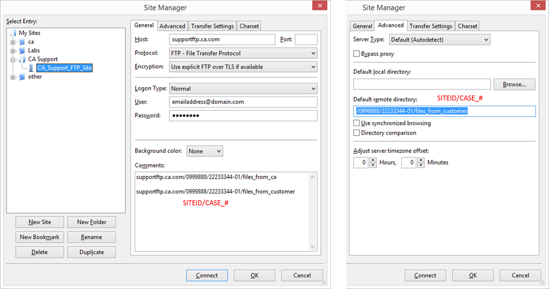

3. Copy the section of ftp to notepad / textpad; Open FileZilla and paste this info into SiteMinder. Ensure the tab "Advance" is populated with the correct PATH without the hostname. Note: The userid (email address) and password will be your CA SupportID userid (email) and password. No anonymous connections are allowed to tickets.
4. FileZilla (on 1st connection) will display the TLS certificate from CA Support. This will ensure that uploading/download files are secure.
5. After connection, you will now be able to see your files, on CA Support site (right panel) and download (or upload) as needed.
Example:
/0999888/22233344-01/files_from_ca (Typically used to download patches / hot fixes / sandbox / etc. )
/0999888/22233344-01/files_from_customer (Typically used to upload logs / images / screenshots / health-check info / etc.)
