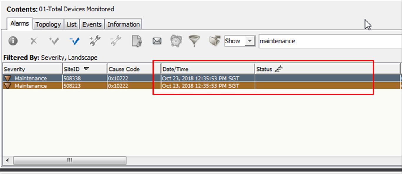

    Hi,
    I have restored my last Spectro backup due to down. Once restored has been completed and spectro is UP, the alarm/date for Critical & Maintenance is change to new date and alarm status is gone. The alarm status is very important to our operator to keep track the alarm. How can i get back my Alarm status if this situation happen?

    Do you have a fault tolerant SpectroSERVER?  The alarms would sync between the 2.  However, there are alarms that are still going to generate updated date/time:
    SpectroSERVER Alarm Synchronization - CA Spectrum - 10.2 to 10.2.3 - CA Technologies Documentation
