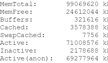

    • System Memory :

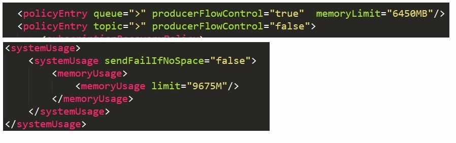

    • On /opt/IMDataAggregator/broker/apache-activemq-5.5.1d/conf/activemq.xml :

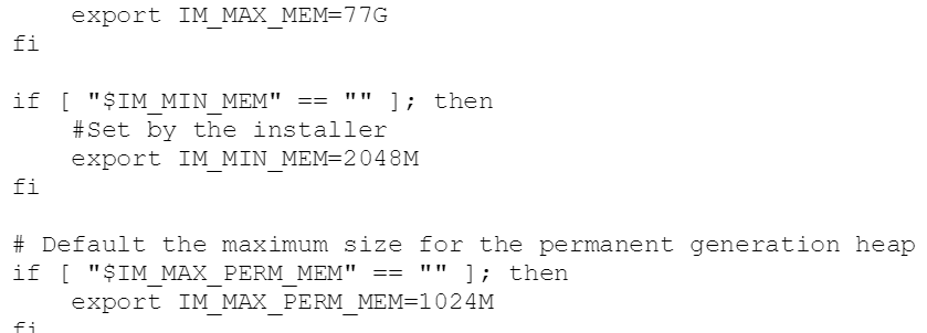

    • On /opt/IMDataAggregator/apache-karaf-2.3.0/bin/setenv :
    Just info, we have 3 Collector. There are missing configurations activemq or data aggregator memory in our machine?
    Thx

    Hi Eksi,
    Yes Irsan is correct.
    To say one word of this problem, the queue becomes full beyond the ActiveMQ capacity.
    So I resolved following three actions:
    1, Allocate much more memory to ActiveMQ.
    2, Allocate much more memory to Data Aggregator
    3, Reduce the managed device by filtering or deleting
    Thanks Regards, Naruhiro
