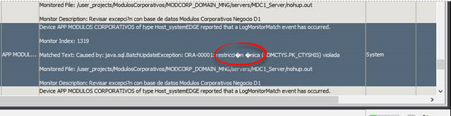

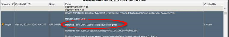

    In CA Spectrum 10.1.2 and CA SystemEDGE agents 5.9 When a trap "watch logfile" is received and the text contains accents is shown in OneClick Console Events tab as the following image:
    This is the text matched in log file:
    Caused by: java.sql.BatchUpdateException: ORA-00001: restricción única (SIINTEGRA.AK_MUL_BITACORA_INTERFASE) violada
    In the AlarmNotifier is shown as follows:

    Other case:
    Other events without accents in the text are displayed correctly:

    Otherwise, I think the problem is related to the utf8 encoding because the character (�)  is presented when there are accents in the words.
