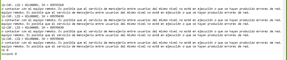

    I see on the log "Is possible that the service is not started or  There was a network problem" but all services is started on the agent.

    Sounds like a firewall issue once the port is open one way that port stays open for 2 minutes in both directions.  Perform the same test with telnet going the other way. In other words from DM to SS then again from SS to Agent.  Then see if caf works to connect from agent.  Wait for 2 minutes test caf again it most likely stops working.  Then try telnet from agent to ss it will most likely fail.  Because firewall is blocking it.
