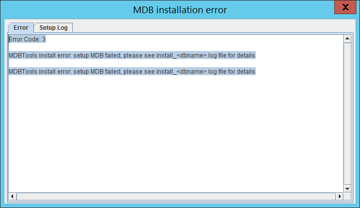

    Currently, I am working a distributed environment of CA SDM 17.
    Server 1: mdb
    Server 2: SDM
    CA SDM has already been installed along with the mdb
    and at the moment, I'm trying to install ITCM on server 3.
    all the parameters were already registered without errors, but when the installation starts, it shows me the following error
    Error Code: 3
    MDBTools install error: setup MDB failed, please see install_<dbname>.log file for details
    Nota: Keep in mind that the mdb was installed with the CA SDM wizard, not the ITCM wizard. and the goal is to install ITCM by joining the existing mdb
    Any idea for to resolve the issue? and how to solve it?

    Following error appears in file %TEMP%\mdb_install\install_mdb.log :
    06-13,14:08:53 INFO - MDBTools_0305E - Error processing foreign key '$usm_t_r00002c7f00000000.xml'; details follow:
    06-13,14:08:53 ERROR - com.microsoft.sqlserver.jdbc.SQLServerException: The ALTER TABLE statement conflicted with the FOREIGN KEY constraint "$usm_t_r00002c7f00000000". The conflict occurred in database "mdb", table "dbo.usm_runtime_component", column 'runtime_component_id'.
    Please check this document which gives a solution for this kind or error:
    How to resolve an common error while installing IT - CA Knowledge
    Maybe it could resolve the installation problem ?
    Thanks.

    I executed the following query, as mentioned the document.
    select * from usm_runtime_component
    the table is empty, and I executed the query
    insert into usm_runtime_component
    VALUES ('Scheduler',NULL,NULL,NULL,NULL,NULL)
    then, the instalation was executed correctly
