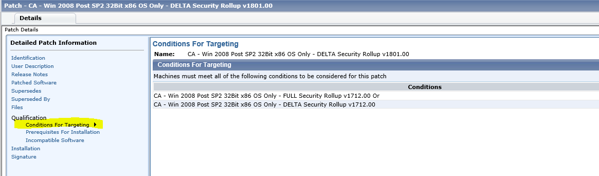

    If some machines appear in the groups "UPM Patch Not Found*" but they should not, check these 3 points :
    •  Make sure that DSM group has been evaluated recently or do a manual evaluation
    •  Check if Software Inventory of the machine looks correct and has been inventoried recently
      Otherwise you coud try a full inventory scan with :
      caf start amagent args -rescan_software -collect
    •  In UPM console, check the "Conditions for targeting" list
    Example :
    CA - Win 2008 Post SP2 32Bit x86 OS Only - DELTA Security Rollup v1801.00
    needs
    CA - Win 2008 Post SP2 32Bit x86 OS Only - FULL Security Rollup v1712.00 Or
    CA - Win 2008 Post SP2 32Bit x86 OS Only - DELTA Security Rollup v1712.00
    Thanks.
