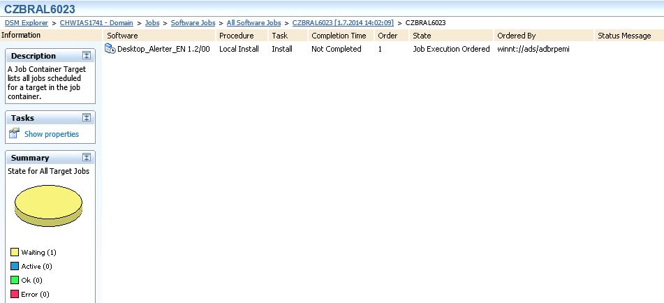

    Posted Jul 03, 2014 02:34 AM
    Thank you Abdul - I was able to create the packe. I have found  that you cannot install it on clean updated system. The installation will break. I had to reinstall .Net and C++ 2010 redist ... to make it work. I come from SCCM and so far I am quite dissapointed with ITCM :-)
    Right now I am facing issue with SD jobs not reporting. The state it Active/Waiting even though the SW is correctly deployed on the computer.
  • 10.  Re: SXP Packager

  • 11.  Re: SXP Packager
    Posted Jul 03, 2014 07:13 AM
    Hello Samad,
    I did recycle DM, SC and Agent. It usually starts that the collect engine will not update anything (just reports Performing Job:  <Server> Collect)
    Then we recycle the CAM with:
    caf stop
    caf kill cfsystray
    cfsystray stop
    cam change disabled
    camclose
    csampmux stop
    cam change auto & cam start -c
    caf start
    start cfsystray
    That usualy helps stuff moving again but the jobs will stay active/waiting even though they installed correctly.
    I have restarted caf on agent and restartet the agen computer. Also restarted Scalability server that handles the agent. Following image is from job status on the DM. The software is installed on the agent, almost immediately when the job is posted.
