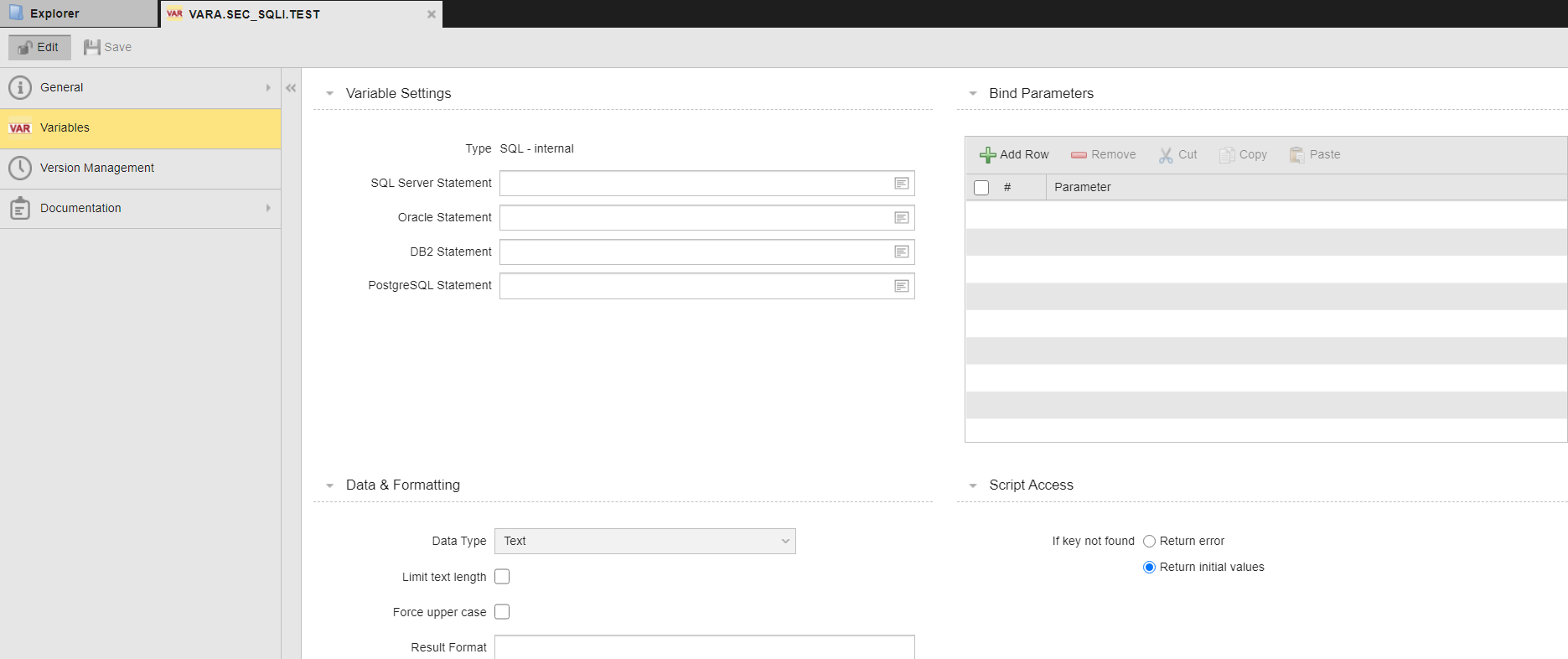

    Hope you're referring to VARA.SEC_SQL from Automic AWI? Attaching screenshot. I am not sure what login should we select to get the results. Can we select default login?
  • 7.  RE: How to extract daily execution and historical daily executions from AWI 12.2.0
    Posted 2 days ago
    Nope, wrong type of object.  There is a VARA.SEC_SQLI that you need to use.  The trailing "I" is important.  It takes you into a similar looking object that automatically connects to the AE database. I just remembered however that your administrators may have decided to restrict access to the AE database, and therefore the SQLI objects may not be available to you personally. So you may be running into site-defined restrictions, and you may need to ask for more access.

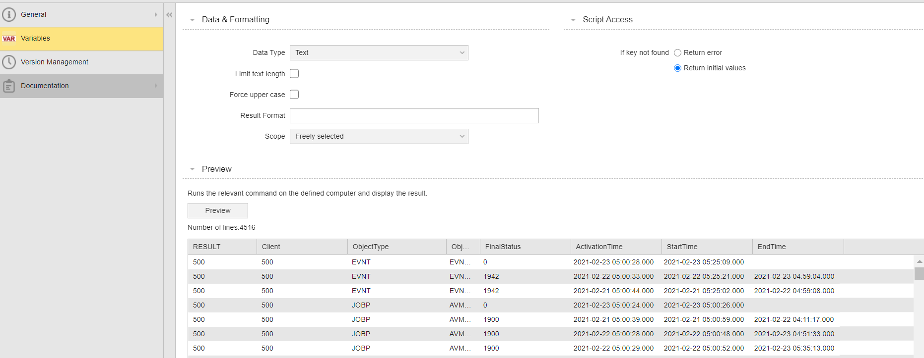

    I got some results on the screen after clicking the preview button, please see the screenshot below. How do we export this data? I don't see an option to export it. Our primary goal is to calculate the average daily executions (JOBS, JOBP, JSCH, EVNT, CALL) and historical daily executions.

    I have used the following sql query as @Pete Wirfs has suggested and we received the no of executions on a particular day. I am not sure how to export this data, I can copy paste it but as it's huge it doesn't allow all the lines to be copy pasted at once and it's more of a manual task.

    To transfer a large SQL resultset from a VARA to a CSV, create a new SCRI object to run this code, and modify it to match your requirements;
    ! CAPTURE THE NAME OF THE UC4 HOST WE ARE RUNNING ON
    :set &HOST# = get_att(host)
    ! RUN THE DATABASE QUERY INTO A RESULT SET
    :SET &HND# = PREP_PROCESS_VAR(EXAMPLE.SQL.TO.CSV.QUERY)
    ! WRITE THE RESULT SET OUT TO A FLAT FILE
    :SET &RET# = WRITE_PROCESS(&HND#,"\\targetpath\example_sql_to_csv.csv",&host#,myloginobject,OVERWRITE)
