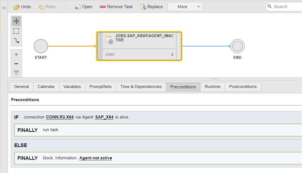

    Hi Rodrigo,
    in case that an agent (Windows, Unix, SAP, RAFTP, ...) is not active the JOBS will wait for the agent (status "waiting for host"). I can see 2 options:
    check the Agent status from the PreProcess tab in object properties:
    check the Agent status in the preProcess tab of the JOBS:
     if you have to check in many JOBS, create an INC onject and reference it in the PreProcess tab.
    regards,
    Peter
    Capture Europe
