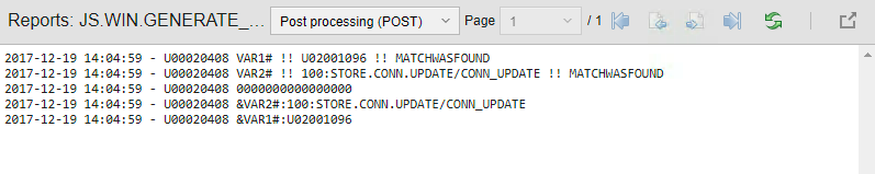

    It is now possible in v12.1 to dynamically create Automic Variables (ex:&MYVAR#) in a script (Pre or PostProcess included) without knowing the names of the variables prior (to my knowledge this was not possible before).
    Here is an example:
    a JOBS object returns an arbitrary output in the following format:
        MATCHWASFOUND|VAR1#|U02001096
        MATCHWASFOUND|VAR2#|100:STORE.CONN.UPDATE/CONN_UPDATE
        MATCHWASFOUND|MYOTHERVAR#|Some Value here
    • the number of lines varies and isunpredictable
    • the second column (which eventually we want to use as the name of an automic variable) is alwaysunpredictable
    Our goal:
      After we are done with the postprocessing, we want:
    • set as many Automic Variables as I have lines that start with "MATCHWASFOUND"
    • Use the second column as the Automic Variable name
    • Use the third column as the automic Variable value
    So, in this case, once done with postprocessing, I want the following automic variables to exist:
    • &VAR1# = “U02001096”
    • &VAR2# = “100:STORE.CONN.UPDATE/CONN_UPDATE”
    • &MYOTHERVAR# = “Some Value here”
     In order do so, we will use a combo of the :CREATE_PROCESS (and related commands) and :GENERATE_SCRIPT_VARS commands
    Important Note: to leverage GENERATE_SCRIPT_VARS you need to set GENERATE_UNDEFINED_SCRIPT_VARS to Y in UC_SYSTEM_SETTINGS
    Here is the content of the PostProcess Tab:
    ! Create a new Data Sequence that will contain the new Variables' Names and Values ! Conceptually it is similar to a "virtual" VARA object with one Key and one Column :SET &VarHND# = CREATE_PROCESS(NEW) ! normal processing of the REP :SET &HND# = PREP_PROCESS_REPORT("JOBS",, "REP",,"COL=DELIMITER", "DELIMITER=*|*") :PROCESS &HND# :  SET &MatchFound# = GET_PROCESS_LINE(&HND#,1) :  IF STR_STARTS_WITH(&MatchFound#, "MATCHWASFOUND") = "Y" :    SET &VarName# = GET_PROCESS_LINE(&HND#,2) :    SET &Value# = GET_PROCESS_LINE(&HND#,3) :    PRINT  "&Varname# !! &VALUE# !! &MatchFound#" ! Add data to the new Data Sequence (delimiter is |) :    SET &CHECK# = PUT_PROCESS_LINE(&VarHND#, "&VarName#|&Value#", "|") :  ENDIF :ENDPROCESS :SET &RET# = SAVE_PROCESS(&VarHND#) ! Generate all Variables stored in the data sequence :SET &ret# = generate_script_vars(&VarHND#, , UPDATE) :P &ret# :P &&VAR2#:&VAR2# :P &&VAR1#:&VAR1#
    and here is the corresponding output generated: &VAR1# and &VAR2# now exist and their respective values correspond the column 3 of the original output:
    An export of the corresponding JOBS Object is attached.
