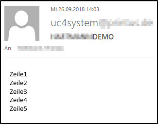

    I can read this "E-Mail Text" [&PRPT_TEXT#] in my Script and send it via [SEND_MAIL]
    Script and Report:
    E-Mail Result:

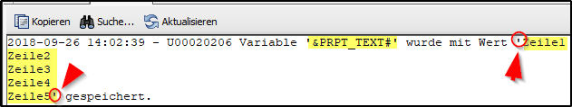

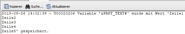

    When i check the Report again - i see that all my "LINE"
    Zeile1
    Zeile2
    are just ONE Value for Automic:

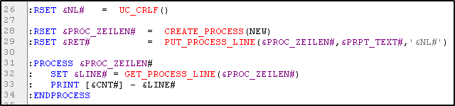

    I tried to seperate / replace each "LINE" with something like this:
    Or this
    I even tried to [PUT_VAR] the "&PRPT_TEXT#" and "GET_VAR" /read\ it out from the VARA to see if i would have seperate "LINEs".
    But even then - it is just one Value.
