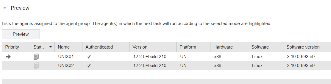

    I.e.
    Preview -- one agent is active, the other one inactive

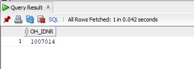

    We were able to get the active agent based on the OHG_OH_Idnr, but not the OH_Name. Thanks to chema14 for this statement.
    select oh_idnr from oh where oh_name='HOSTG.ACTIVE.OR.INACTIVE';
    Result:

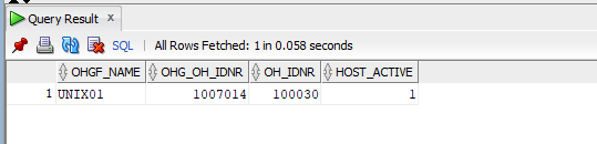

    Now the current statement base don the OHG_OH_Idnr
    select OHGF_Name, OHG_OH_Idnr, OH_Idnr, HOST_Active from OHG
       INNER JOIN OHGF ON OHGF.OHGF_OH_Idnr = OHG_OH_Idnr
       INNER JOIN OH ON OH_Name = OHGF_Name
       INNER JOIN HOST ON OH_Idnr =  HOST_OH_Idnr
       where OHG_OH_Idnr = 1007014
       and Host_Active=1
       ORDER BY OHGF_Name;
    Result:

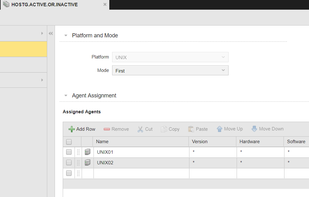

    Please note that the query uses the predefined variable &$CLIENT# to specify the HOSTG's Client.
    IMPORTANT: What this query actually does is: it maps the HOSTG's entries to Agent names. So this will only work for HOSTG entries where the full Agent name is specified inside the HOSTG, see screenshot
