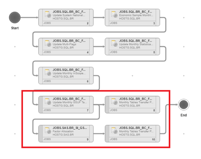

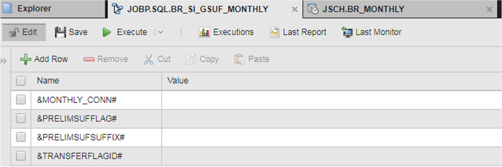

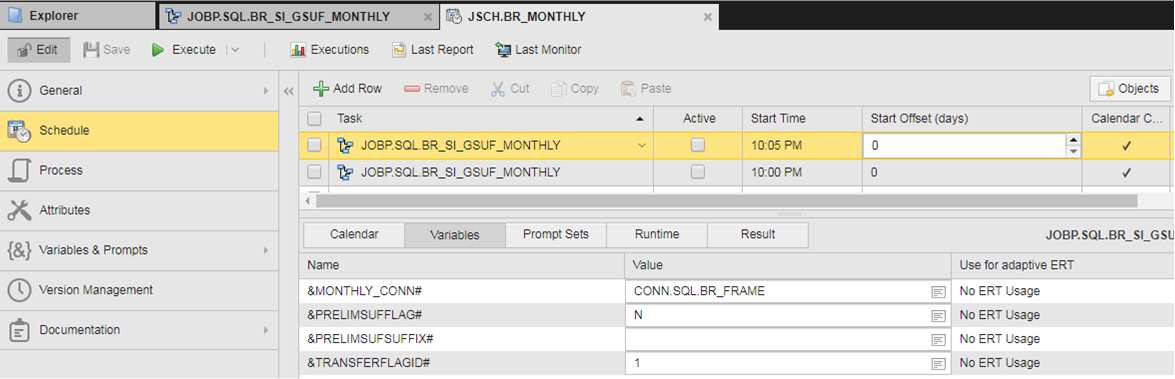

    I created a workflow that I would like to schedule several times during the month with different parameters.  I did find a way to do this by adding variables at the workflow level, and assigning their values in the schedule:
    The problem is that, based on some conditions, I want to skip the last tasks in the workflow.

    So I added Preconditions in JOBS no.7 as follow:
    So far, so good...  this is working!!  So I thought I would add the same preconditions to the last 3 JOBS. This is where I got screwed!!  Because in the Dependencies tab on JOBS no.8, I don't have the option of selecting "ENDED_OK_OR_SKIPPED"!!  So the job aborted before even analyzing the preconditions...

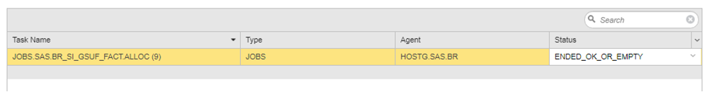

    Here is what I finally did...
    I created a JOBI that I included in the Pre process of the last JOBS:
    !EXECUTE ONLY IF JOBS EXECUTED IN JOBP
    :IF SYS_ACT_PARENT_NAME() NE " "
    : IF &MONTHLY_CONN#  = 'CONN.SQL.BR_FRAME'
    :    IF &PRELIMSUFFLAG# = 'N'
    !      ENDED_EMPTY / STOP NOMSG !
    :      STOP NOMSG,55,"DO NOT RUN IF WORKFLOW FOR FINAL BRFRAME"
    :    ENDIF
    : ENDIF
    :ENDIF
    End then I updated the Dependencies with the following:
    It's working !
