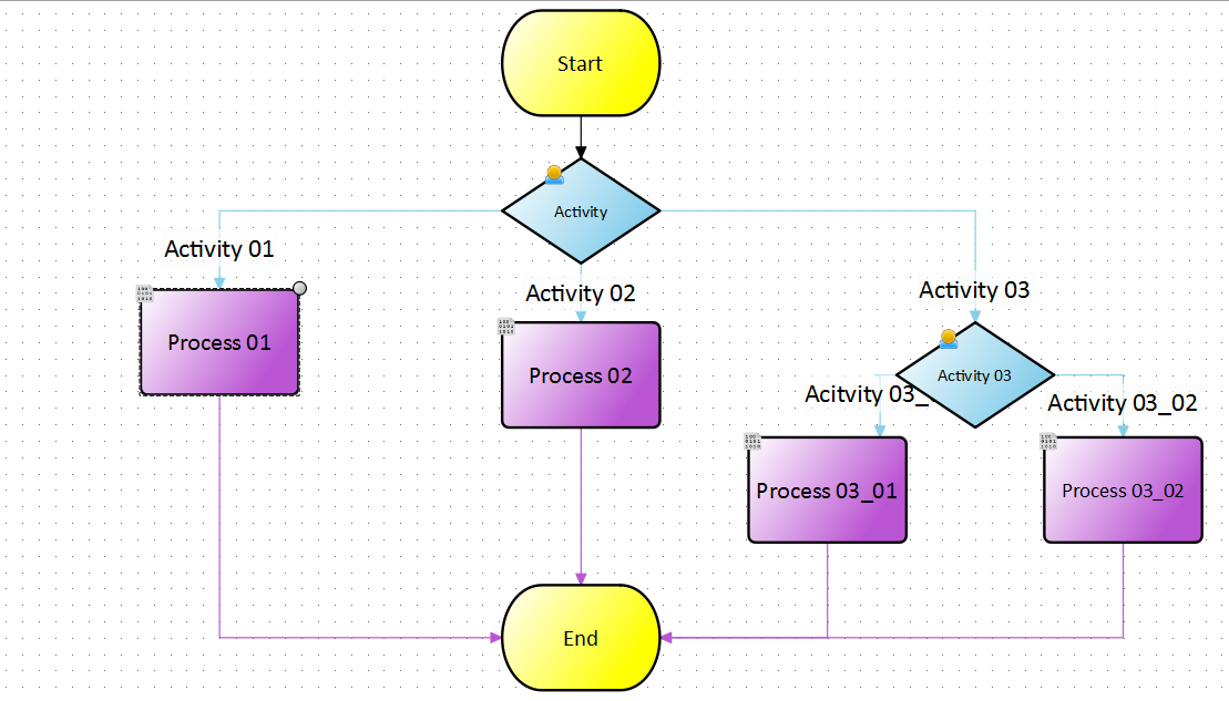

    To explain our situation clearly please consider the following flow
    The model Test101 represents model where one is to take decision to perform 3 activities. Attached pic o1 for same
    -Activity 01
    -Activity 02
    -Activity 0ctivity 03 is again further divided into Activity 03_01 and Activity 03_02.
    The description of the test case changes depending upon the path traversed post the decision block, so in our case we would have 4 different test case description.
    --The  Test description of Activity 01 & 02 is decided immediately after the first decision block while the test description of Activity 03_01 & 03_02 is decided after the second decision block, as seen from the model.
    Can you please show how to map the test case description unique to a particular test case (Different from Block description) into ALM.

    Pic 01
    The Test Flow

    Hi Everyone,
    You can map the ALM "description" to the "Description of Blocks" field - shown below:
    In regards to the second question; "In addition to the above query, we would like to have the test case name same as the path name."  - you can use the Path Naming Template, as shown below:
    Hope this helps.
    Ryan
