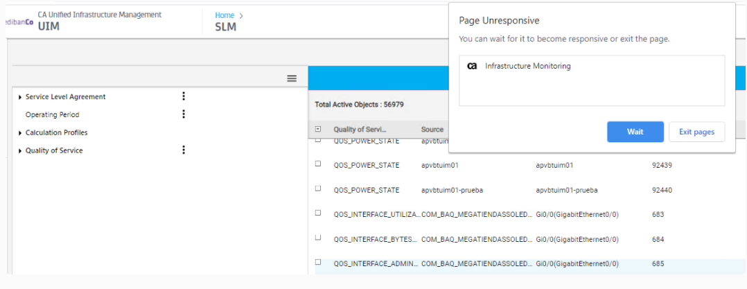

    Hi everyone.
    Does anyone know any method to delete old qos from the DB. In UIM 2033, doing it from SLM is a nightmare. In UIM 201 it was a bit more reliable, now the experience is not very comfortable.
    In fact I tried to delete more than 1000 qos, but apparently it did not ... I'm giving it time to see if data_engine does the deletion, I just manually reboot the probe

    Hi guys,
    I have this same problem to delete QOSs, the WEB page hangs and I need to end the process in the windows task manager and log back into the OC.
    Really this SLM page is very bad, I created an idea so that they can improve in the next versions.

    Posted 4 days ago
    Colleagues, thank you very much for your contributions. What I did was delete the data from SLM by groups, then a restart of the data_engine, that helped me to delete the data I needed, but it cost me a lot of effort, SLM is now less friendly than before ...
