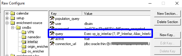

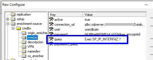

    I am working to migrate UIM 20.1 to 20.3, and I have some configurations in nas / alarm_erichment for populate data in alarms. One of the configuration captures the ip, alias, interfaz and device name when an interface is operationally down. Due to the complexity of this, a stored procedure had to be created and executed from the NAS in "enrichment source / cmdbs" the SP call with the data coming from the alarm's met_id it's works. This in UIM 20.1 is working perfectly, but ... in UIM 20.3 no, the problem is I don't know how to call the SP for Oracle. I already tried the SP from an Oracle console and it works, but I am missing the call from nas.
    The call from nas that workiing (UIM 20.1) is ---->
    In UIM 20.3 I tried calling the SP in different ways but it didn't work for me...
    Exec SP_IP_INTERFAZ ?
    Exec sp_ip_interfaz (?, IP_Interfaz, Alias_Interfaz, Interfaz, dev_name)
    note: the "?" is the met_id from alarm
    Any idea for to exec a SP in Oracle DB???
