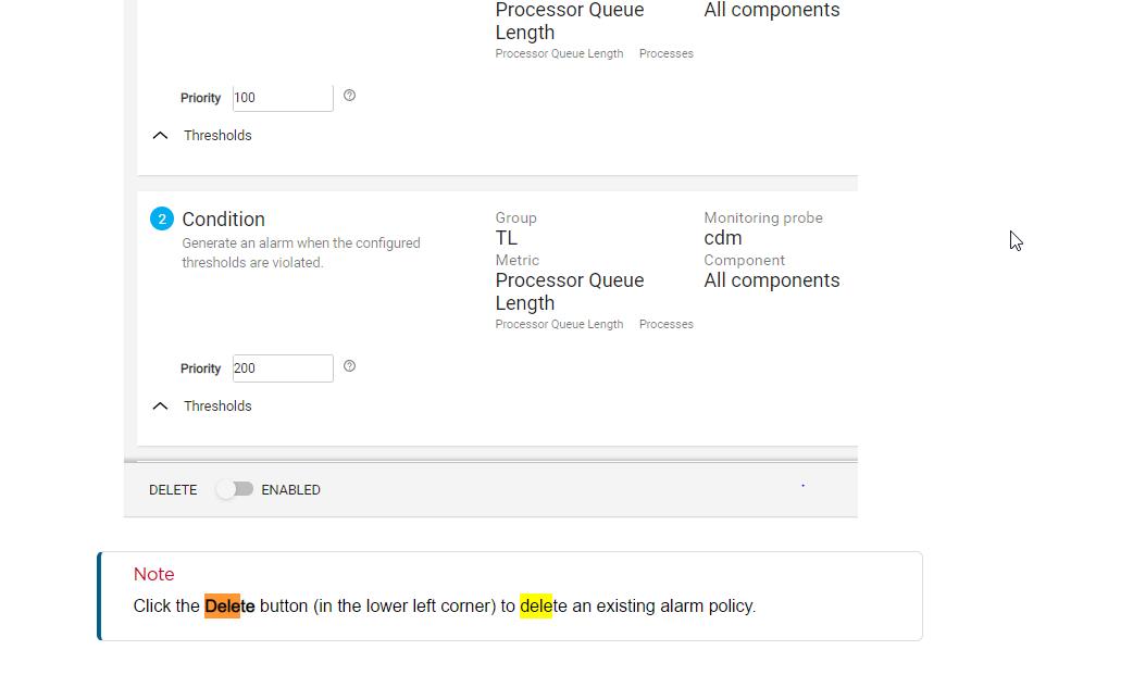

    1 more question:
    does clicking on the Delete button (in the lower left corner in the given Alarm policy) delete or only disable the existing alarm policy? as based on the documentation description in "How do I disable (or enable) an existing alarm policy?" it seems to be the same feature for both features, so im confused now.
    so how to delete and how to only disable the policy?
    in my case, if i click on the delete button, it shows disabled status for it, but i want to completely delete it from OC as well.
    so how does it work, please?
    thank you,
    stefan

  • 16.  RE: Delete alarm policy version 20.30
    Broadcom Employee
    Posted 12 days ago
    and where is this delete button please?
    i can only see 1 delete-enabled slider button in the left lower corner, exactly like it's on this image in the docs. and if i understood you correctly, it's for disabling-enabling.
  • 17.  RE: Delete alarm policy version 20.30
    Broadcom Employee
    Posted 12 days ago
    The slider is for enabled disable, not enable delete.
    clicking delete, deletes the profile.
    Support Engineer
    Broadcom
  • 18.  RE: Delete alarm policy version 20.30
    Broadcom Employee
    Posted 11 days ago
    omg, it's one of the worst UX design i've seen. the delete button doesnt have any border, so it doesnt look like a button, but as a plain text. it has the same font and color as the enabled on the other side of the slider. and with the slider in the middle and the 2 text (delete and enabled) on its both sides, it seems that the delete and the enabled are the 2 values of the slider.
    if you know the designers of UIM, please let them know this reference.
    and thank you very much David for your help in this topic!
