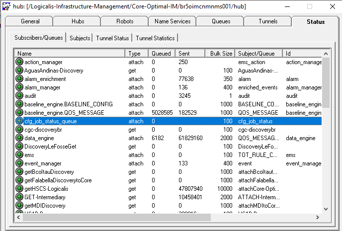

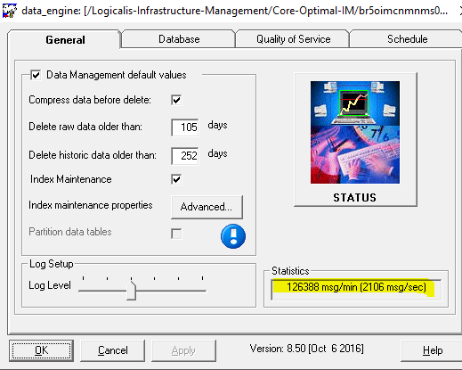

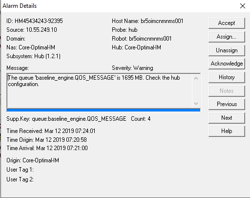

    Hello CA Guys,
    We are facing a problem of queued on baseline_engine probe.
    Always, the queue got bottlenecked.

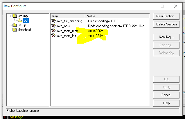

    We already changed the configuration of memory xms on probe, like follow:
    Anyone have an idea about hohw to solve this case?

    We deployed the probe baseline_engine 2.77 version on Hub Primary and all Hub Secondary, but unfortunately the data queued on Primary Hub again and again and again.
