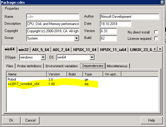

    Not specifically a 9.0 defect but one of the pushes in 9.0 is to move to the latest VS 2017 runtimes.
    One of the nifty features of that is that the vs2017_vcredist_x64/32 package failed to include the /norestart option so if you deployed this package, you were at significant risk of it rebooting the system being deployed to.
    CA then releases version 1.01 which fixes that defect.
    Problem is this:
    Handily, the cdm package forces the selection of the version 1.00 package.
    So if you just downloaded the fixed package and then imported it assuming that the latest version would be used, you would be sorely mistaken. And you'd still be rebooting servers randomly as you deployed CDM.
    And if you deleted the old version, like you should have, then the CDM package is broken. The equality requirement can't be satisfied.
    The fix is obvious, just change the dependance to ge instead of eq but this should never have gotten out the door in the first place.
    Ugh. CA, you need to do better than this.

    Hi, Garin.
    We do apologize for this. Yes definitely we agree that we should have done better.
    We are aware of this issue and today we detected 2 probes still refers to 1.00 (with eq)
    Cdm 6.33
    Robot 7.96 (come only with 9.0.2 install)
    We plan to replace those archives not let happen unwanted OS reboot.

    So Here is quick action list
    1. MUST DELETE the following packages from archive
                      (*) Mandatory for all UIM 9.0.2 users and UIM 8.X users those who imported these packages already.
    vs2017_vcredist_x86 version 1.00
    vs2017_vcredist_x64 version 1.00
    1. MUST DOWNLOAD the following packages (Available in http://support.nimsoft.com) and import them.
                      (*) Mandatory for all UIM users.
    vs2017_vcredist_x86 version 1.01
    vs2017_vcredist_x64 version 1.01
    1. In archive GUI, double click cdm 6.33.
    [win64] - [Dependencies]. Double click vs2017_vcredist_x64. Change [dependency type] from [eq] to [ge]. Press OK
    [win32] - [Dependencies]. Double click vs2017_vcredist_x86. Change [dependency type] from [eq] to [ge]. Press OK
    1. In archive GUI, double click robot_update 7.96
                      (*) Mandatory for all UIM 9.0.2 users only.
    [win64] - [Dependencies]. Double click vs2017_vcredist_x86. Change [dependency type] from [eq] to [ge]. Press OK

    Posted 12-13-2018 08:03 AM
    Follow up.
    Recently we issued
    - cdm 6.34
    - robot 7.97
    VS2017 dependency of those have been modified with "ge", so it works with 1.01 version of VS2017
