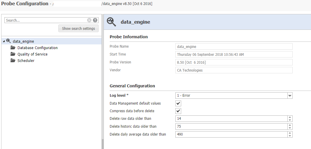

    We using Oracle DB. This setup for data_engine.
    This for data_engine schedule setup.

    Suggestion: Do you really need 360 days worth of hourly data? I'd use the Admin Console and configure the data_engine probe to roll up the hourly data to daily after say X # of days. Your holding onto too much hourly. Just FYI I have mine set to:
    14 days of RAW
    up to 75 days of hourly then
    up to 490 days of daily
    0 - 14 days is RAW, 15 to 75 days is hourly data, 76 to 490 is daily.
    This shrunk our DB size from 1TB to ~250-300GB now.
    Also what medium is your DB running on? Hopefully SSD's otherwise your I/O from the DB inserts is not doing to handle that much data traffic.

    Btw for reducing the hourly and daily data, can we reduce it directly let say from 360 days to 90 days? Or we should reduce it gradually for example reduce it 60 days daily?
  • 23.  Re: Data engine slow data insert
    Posted Sep 12, 2018 12:17 PM
    You would have to do it gracefully. You'd have to wait for the QoS trimming to kick in and wait for it to finish before you can then reduce the #'s more. So the way you have it configured you have it running once a day starting at 2:40AM.
    You could change that so it runs the QoS clean up every 2 hours, adjust the #'s then check how much QoS is not getting trimmed with the #'s you then specified. There is a DB query you can run that allows you to check what QoS is not trimmed off according to the #'s you specified. Not sure if it works with your Oracle DB but the link to the page is:
