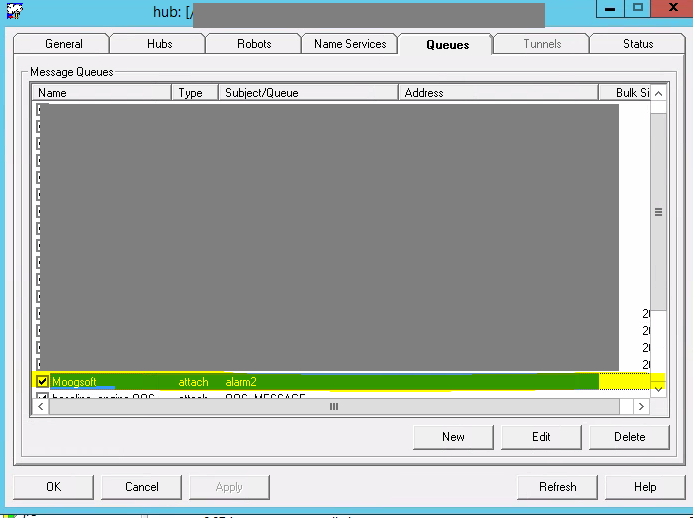

    For this purpose client has created an attached queue named Moogsoft in UIM primary hub with subject alarm2 and it is being subscribed by the Moogsoft LAM.

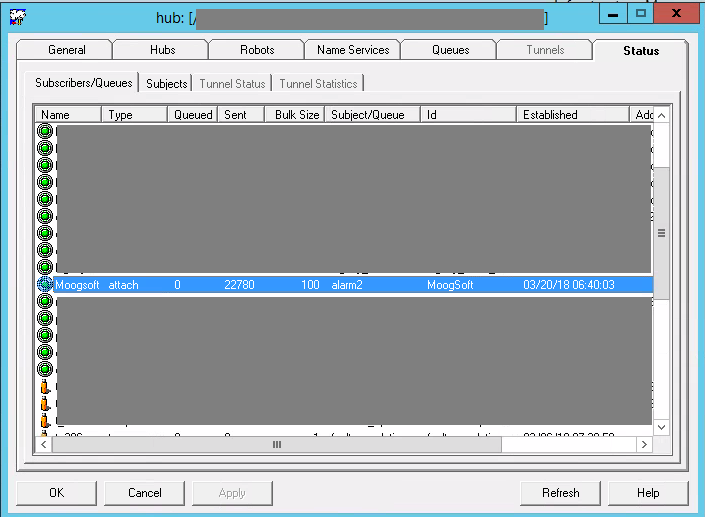

    Attaching the Queue and the Status fields output:
