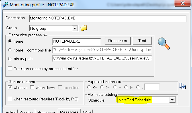

    One way to achieve this is by using the process probe .
    Create a Schedule in the process probe to look for a process after the schedule job run time and assign the schedule to the process profile .
    For example the schedule job you are referring to might be running at specific time of the day , say 10 AM to 11 AM after which it should be terminated,  if not you need to get alerted .  Create a schedule to look for the process after the schedule time , like 11:05 AM and assign it to the process profile so that the profile gets activated after the schedule job run time. If the process still exists , it will send you a alert based on which you can take an action .
