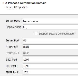

    I've been following this TEC DOC How do I reconfigure PAM to modify Ports, authentication and Database Settings?
    This was my first configuration.
    Figure 8
    After that, i was following the TECDOC using
    C:\Program Files\CA\PAM\server\c2o\.c2orepository\media\Third_Party_Installer_windows.exe
    And this is my new configuration
    But when i tried http://<server>:8081/itpam , i'm getting "This page can’t be displayed"

  • 2.  Re: How do I reconfigure PAM to modify Ports?
    Best Answer
    Posted 10-29-2017 09:53 PM
    "Address already in use: JVM_Bind" usually means there is already a process listening on a port, which from the log text you include looks to be port 8009.  I'd try a server restart to kill all processes, then follow https://support.ca.com/us/knowledge-base-articles.TEC1541094.html .  You can get Windows Task Manager to display the PID, to help you to locate the process that is holding the port.
    In the worst-case scenario you might just have to uninstall and reinstall to clear out all of the JBoss components.
