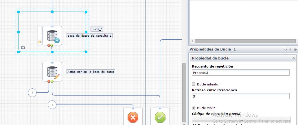

    Hi, mi problem is simple, don't cant end the cicle while in process, never ends, the post execution code is in query BD, Base_de_datos_de_consulta_1
    I think put one else after this "}", but not have any idea how to continue the process flow
    Thanks for your help.

    It's really simple, change the "Recuento de repetición" to a boolean variable initially with a false value, then in the "Código de ejecución posterior" change the Process.I to your boolean variable and if status is equals OP change the variable to true value.
    If I'm wrong, reverse the value of the variable starting as true and to leave the lopping to false.

    Hi Douglas, i find the problem.
    My variable Process.I has not numeric and not added, this variable are string.
    thanks for your help!!
