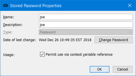

    Hello,
    First, make sure you have checked the box for 'Permit use via context variable reference' when creating the stored password. To look this up dynamically:
    1) Create the stored password

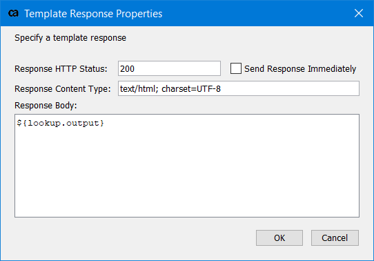

    2) Add a 'Look Up Context Variable assertion where the variable ${user} is set to the stored password name
    3) Reference the output of this assertion, ie: ${lookup.output}
    This will display the password for the user specified.

    Sample attached, just replace the username variable with an appropriate stored password name in your environment.
